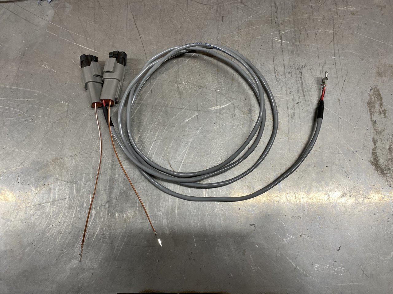

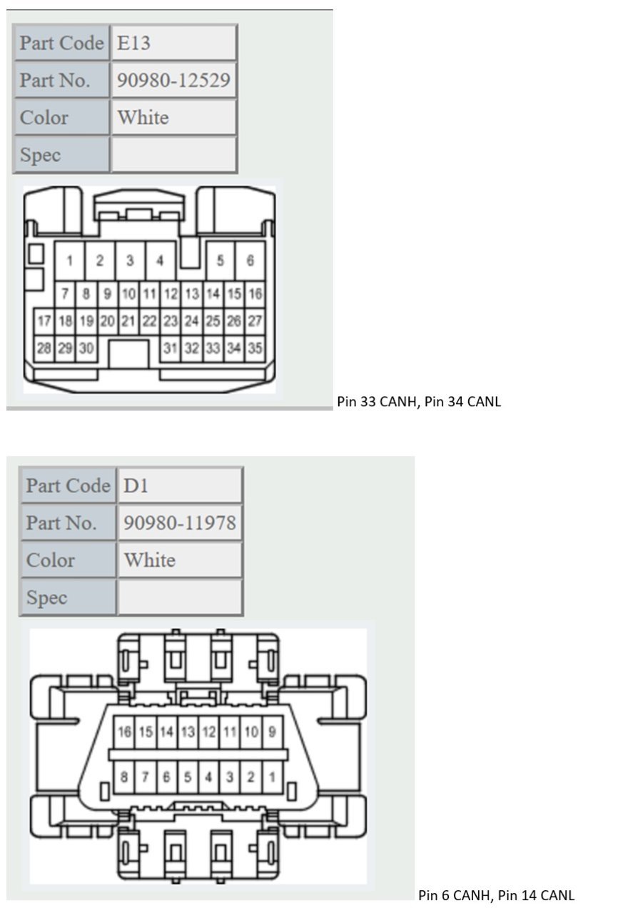

    Just in case anyone else wants to put a Taco ECU in their 1GR-FE Hilux this is the harness and wiring that you need to make and put in. I was going to do a little .pdf guide for people when I get a chance. The Deutch plugs are 120 Ohm resistors thanks to @Au1gr . Means swapping back to stock just pull the plugs and put stock hilux ECU back in.

    My shit is all stock.
    I’d like to see that.
