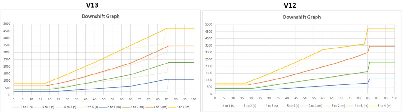

    V13 trans tune has been flashed on the truck. Like stated going to give it a week of driving (cus whelp covid is limiting the amount im driving) But in errands today it acted exactly like i wanted which is a damn good thing, makes the truck very lively. Im feeling good about this revision for v13 to make it the actual v13 (i have gone through about 3 or 4 revisions of this v13). V13 pays attention to engine RPMS in relation to the same throttle input in every gear as well as more aggressive (quicker) downshifts deeper into the throttle to make it more sporty! Good things a coming.

    I have also spent quite a bit of time re-doing the Excel doc to simplify the behind the scenes graph data etc, zero need to interpolate data points as excel can draw graphs regardless as well as simplify data to make it easier for people to see what has changed vs stock. (no more difference values as too many axis values have changed as well).

    V13 ND4's Shift Points!
    v12 here- https://www.tacomaworld.com/threads/hp-tuners-for-2005-2015.600793/page-243#post-22053091
    So attached is the latest public release deemed "V13" I have gone through several revisions of this tune of which has been centered around downshifts. V12 started this in the 2-1 and 3-2 shift but v13 is FAR more aggressive in ALL downshifts. Now you might think... i dont want a more aggressive downshift. What I mean is we are making them occur sooner into throttle pedal input and or truck slowing down due to a hill. This actually makes the downshifts less "bury my foot then shoot to the moon with rpms", making the downshifts feel more natural and less jarring from a drive ability standpoint. No more lugging a bunch when turning up into a hill before a downshift, it simply goes ok ill drop a gear!
    I have also gotten rid of lots of unneeded data within the excel doc (interpolation table bullshit I like the K.I.S.S method. ). No longer are difference from stock values used. The data is simply there inputted to the main page and anything highlighted in the peach color is a deviation from stock values. Also made a SLIGHT change to my shift pressures to make my OCD more happy (i like graph lines straight).
    As always comments, suggestions, want me to throw it in your tune, want me to make a custom trans tune, hit me up!
    ~ND4.
