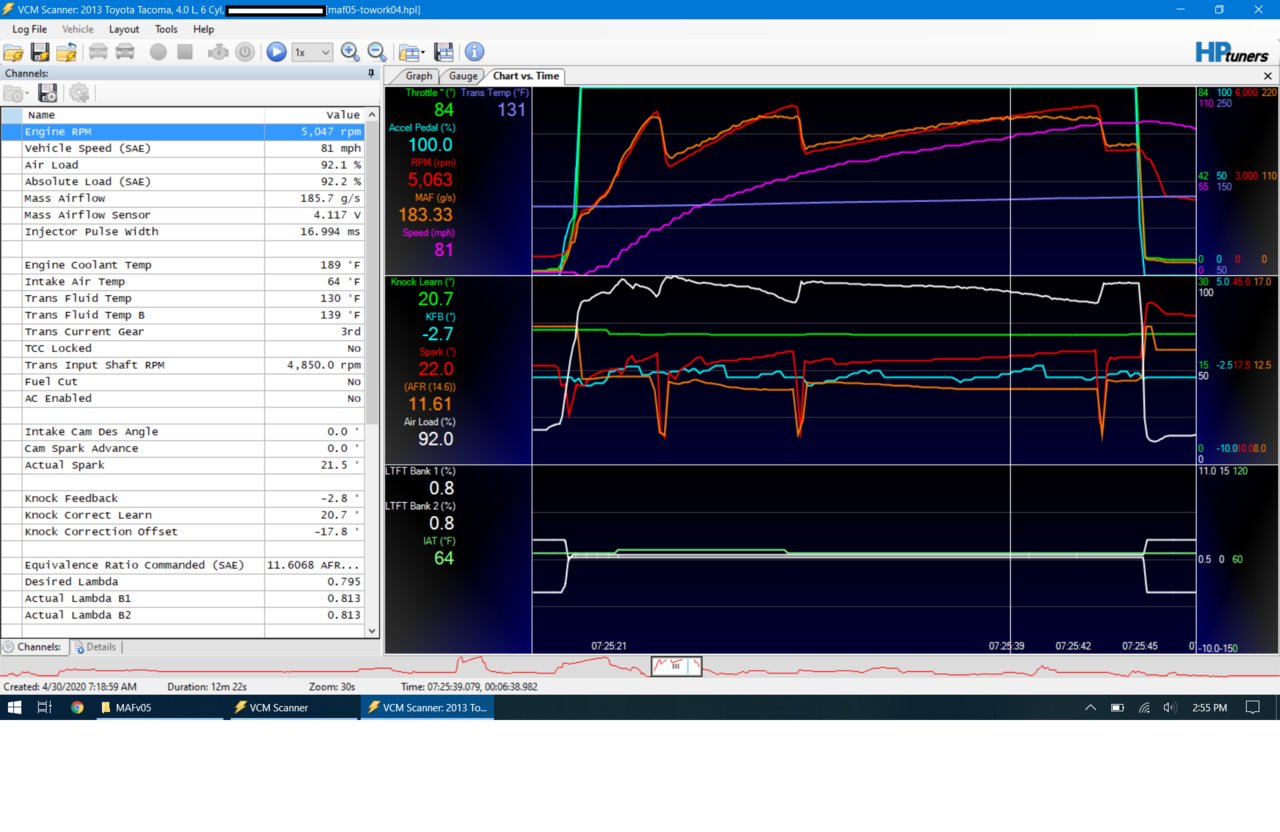

    You may look at working over the MAF curve at higher airflow. Just looking at the specific highlighted spot, your commanding .795 lambda and your O2's are pegged at .813 (and we know they're richer than that, but capped). Overlay your commanded lambda and observed lambda and see where they deviate. You can apply the percent error to bring observed in line with what you're commanding.
    That's the simplified version. If you would like, I can assist in more detail. :)

    Yeah we really cant see below .813 on the stock O2's can we..... BUT, there are times when we are below stoic, but above .813 where we can see the difference so i see what you are getting at. PM'd

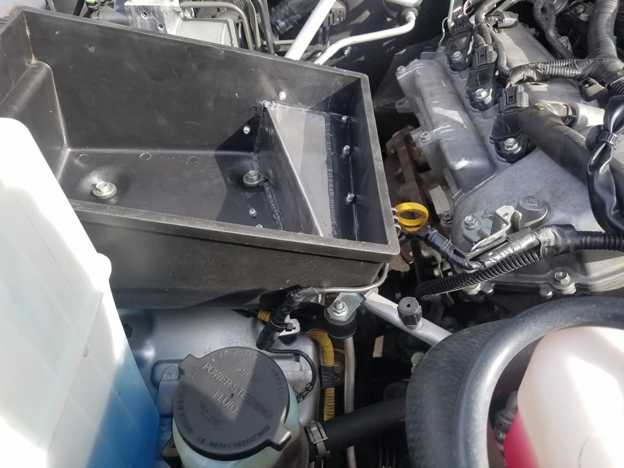

    Just know that the A/C lines are routed differently on 2012+ trucks to accommodate space for the SAI system. This may not affect the K&N intake, but it did affect the TRD Intake I tried to install. I had to mod it "a bit:20200329_092919.jpg 20200329_122732.jpg

    Ok, I think you’re right about the K&N that the AC line probably won’t be affected as it doesn’t have an air box like the TRD or AFE intakes.

    Gotta say to the team here.... @JustDSM knows a thing or two about a thing or two as he was right! Under OL drive conditions, and above the lower limit of .813 my desired vs actual were off....... unfortunately just as i thought i was good on maf tuning HAHAHA. But i gots a good grasp on it now and luckily we have a maf correction table that i can utilize for those weird situations (IE high rpm, low throttle openings where things dont follow higher load situations)
