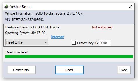

    Ok I got the latest beta downloaded and installed. What exactly would you like me to do? I was able to connect to the vehicle once I opened VCM scanner

    1. Open up the VCM Editor
    2. Ensure you have WiFi/Hotspot
    3. Turn ignition key to "ON"
    4. At the top center of the VCM Editor, you'll see the little computer chip icon with a green arrow (Read Vehicle). Click that.
    5. You'll get a pop-up window. Click on "Read"
    6. You may get a pop-up or two telling you that your ECU is not readable, etc. etc. Thats normal, as it's describing the virtual read. Just click ok through those and if it's supported you'll be prompted to save the read file. If you're able too, save it, and email that to me and I'll confirm if it's good to go or not.

    Thanks for the instructions! It is not prompting me to save the file, it is only reading it and then this is what it's showing

    Looks like it's a no-go at this time unfortunately. :(

    What a shame. Hopefully they provide support at some point!I emailed Chris back in early february this year and he said they hadn't made any more progress at that time. Fingers crossed they pick it back up one day
