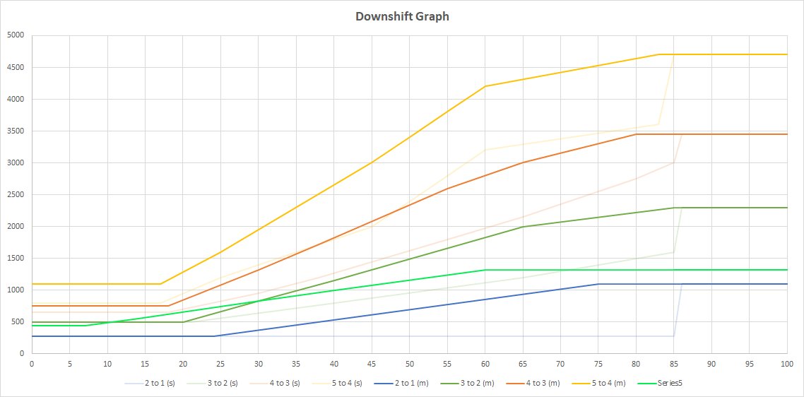

    Haha Glad you are liking Batch 1 of the Spicy Taco Sauce. Im curious, get down to a speed where it can downshift to first, (rolling at 20mph or so) and floor it making sure it goes down into first. I want to make sure i didnt raise the far end of the 2 to 1 shift to make it pointless and have it shift too quickly after downshifting.

    Shift points confirmed awesome @nd4spdbh
    It makes sense as to why the truck was just a pig and falling on its face everywhere. The transmission tuning was corrupt for quite some time now! I love my truck again and feel like it has huevos through all the RPM band again.

    Im going to revise the spicy.... i made the downshift taller than the upshift oops. for the 2 to 1, in a specific case (~2500rpms in 2nd) you would downshift than immediacy try to upshift in the higher throttle inputs. @zippsub9 @12TRDTacoma and @snowsk8air2 and the few others that have the spicy taco sauce. Ill be reaching out

    haha.... ill use that excuse for my eff up on STSB1 2-1 top end downshift .... But yes, all shifting is based on driveshaft output speeds re-gearing / larger tires wont change a thing as far as when the trans actually shifts.

    Spicy Taco Sauce Batch 2 is READY!
    @snowsk8air2 @12TRDTacoma @zippsub9 AND ANY OTHERS WITH STSB1 disregard your STSB1 tunes, and apply the STSB2 asap (if you keep STSB1 for any length of time be careful with 2 to 1 downshifts at higher throttle inputs at the higher speeds of what 1st gear is capable of, as im not sure how things will react) STSB1 has been pulled, and those three I applied it two have been mailed new STSB2 tunes.
    I fixed my eff up. 2 to 1 (dark blue) at 75-100% throttle moved down to be below the 1 to 2 upshift (neon green).... doh. Everything stated in the initial post sill applies.

    always wanting more! haha.... drive the spicy batch 2 for awhile and we shall go from there, cant get more much more spice on the downshifts without creating hunting or going above upshifts. which means id have to add more to upshifts and make them occur even later.
