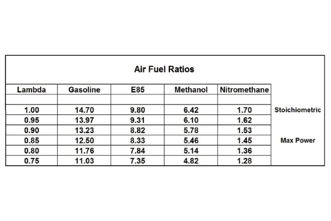

    If you go into leaner parameters there is a chance that while you may make the same power you may run into knock and pinging under load and acceleration, which is why 12.5 is usually what you want to tune to in order to prevent knock and pinging all the while making the most power you can out of the fuel. You go one point lower for high power engines or high compression ratio engines to compensate for the extra heat being generated inside the combustion chamber. Example, my H/C/I LS2 GTO making over 450HP to the wheels required tuning to around 11.5 AFR under wide open throttle despite being NA due to the big power it was making and the high 11.5/1 compression ratio to prevent knock.. my Tacoma is also right around 11.5 AFR under wide open throttle due to the extra heat being generated by boost despite lower compression to prevent knock. The extra heat generated by the blower requires additional fueling to keep the combustion chamber cool.
    Here's a nifty chart which should help.

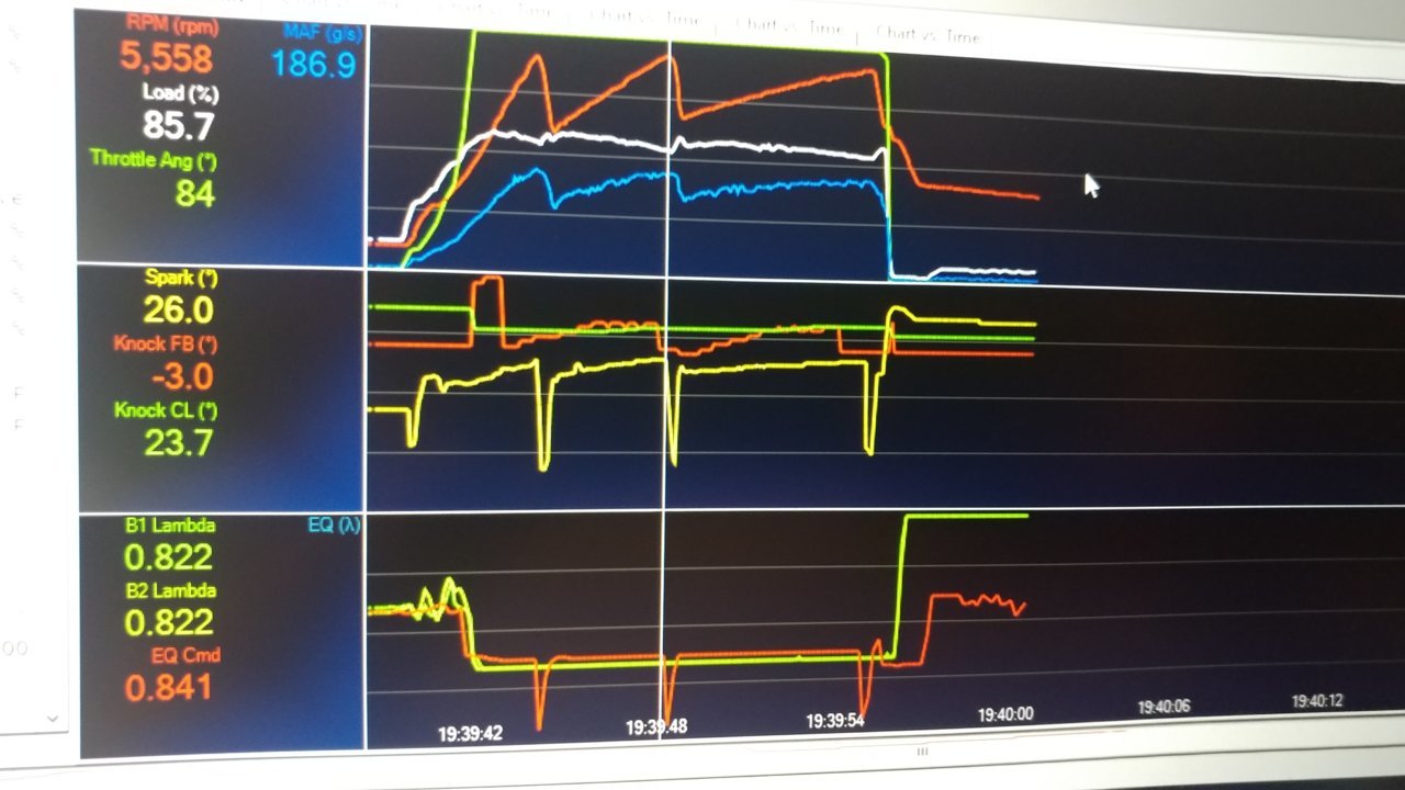

    Is there no real time data logging ability with the factory WB O2 through the ECU via the HP Tuners Software/hardware? It can not be displayed in real time via laptop, tablet, etc?
    I did my share of learning and then I feel like I had and still have a very good understanding of modern EFI systems. I know that the previous systems I worked with (both denso ECU from 2000-2007) used NB sensors and were not ideal in closed or open loop under and amount of load, often not hitting targets called for on the maps. The MAF was part of the problem but I can't accept that the stock sensors are good enough without some data or at least first hand experience with specific claims. If the ECU really doesn't monitor the WB sensors outside of the NB range, that is another question mark about why and how this system/logic works.

    They will display in real time with a laptop, and datalog in real time with the laptop .
    12TRDTacoma likes this.

    Example
