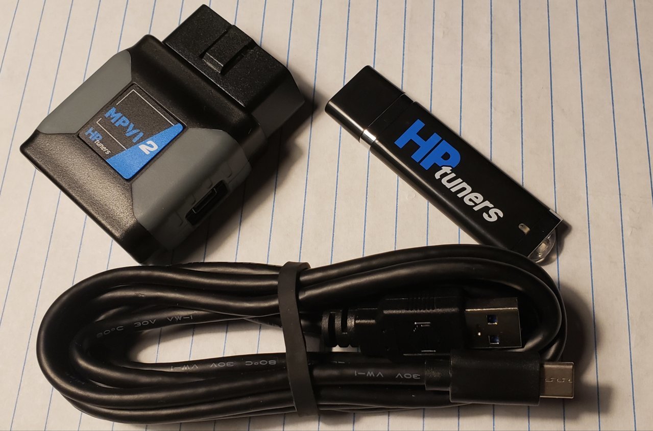

    Hello everyone. I'm only on page 82, but my order just arrived. I'm jumping ahead to ask a question. Are you all still using beta version or full version? Thanks in advance!

    #141634
    4,573
    Halfmoon, NY
    14 DCLB
    Shit bolted onto other shit, and junk.
    I have only used beta from the start and still do.

    Pretty sure @JustDSM has been helping them with their beta testing as well. If these were GM or Ford, I probably would not be on beta but I think they are continuously updating and just breaking open Tacoma’s

    There currently is no full version. Only beta. Beta rocks too.
    Like @zippsub9 said if it was GM or Ford it would damn we'll be full version "stable release" by now.

    Looks like they are packaging with a much thicker USB cable now too.
