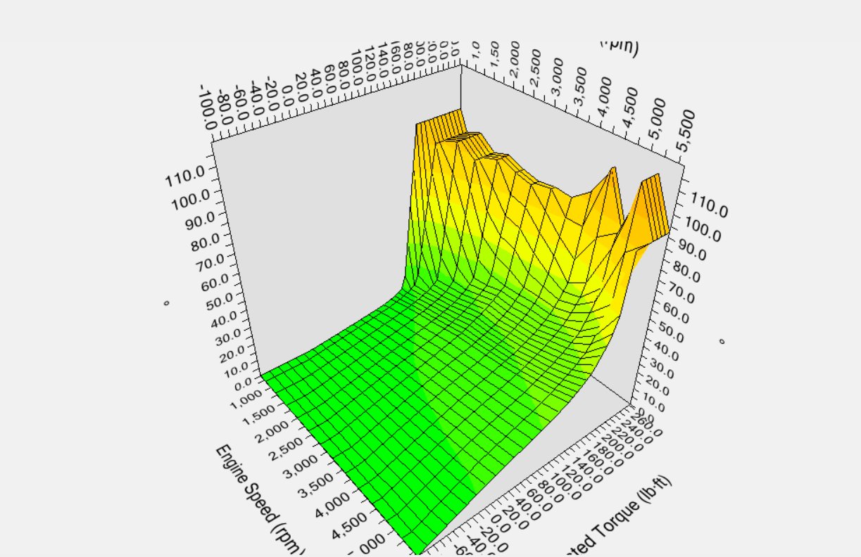

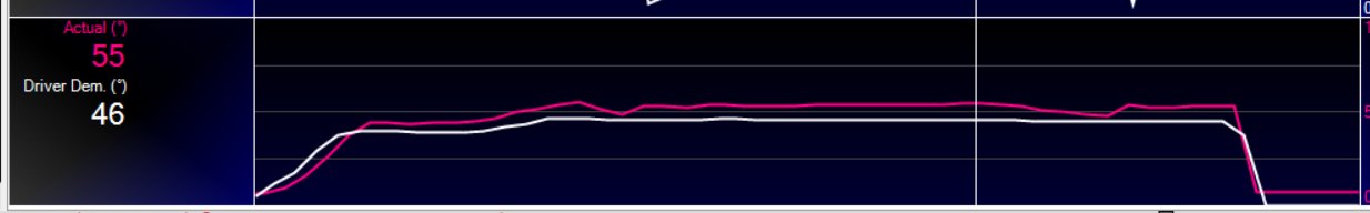

    Anyone ever mess with the throttle torque based limits?
    For one, what the hell, values above the max 89.8 and really spiky.
    Reason im bringing this up is i am seeing some wacky throttle blade activity under moderate acceleration, stead accelerator pedal yet dips in throttle blade.

  15. May 24, 2020 at 9:49 AM
    #6455
    420taco
    420taco Well-Known Member
    Sep 17, 2018
    #266514
    417
    Justin
    PA
    Noticed this myself after really getting on it yesterday.
    so we need to just max out that table? :D
    12TRDTacoma likes this.

  17. May 24, 2020 at 10:40 AM
    #6457
    nd4spdbh
    nd4spdbh Well-Known Member
    Oct 7, 2013
    #114055
    14,621
    SoCal
    13 DCSB TRD OR v6 Auto
    Stock Super charger tunes actually have gear based limits below max for 1st gear as well in the mid rpm range.
  18. May 24, 2020 at 11:18 AM
    #6458
    OVTune
    OVTune Well-Known Member
    Mar 27, 2017
    #214557
    8,112
    OVTune
    I have tuned those tables quite extensively.
    If you get throttle reductions you need to tune these maps.
    You can also use these if you are not seeing the throttle you want at part load / part throttle, etc
    and if you set them higher than the maximum limit...I'll have to double check what it is, *I think 115%) you get instant limp mode and no throttle.

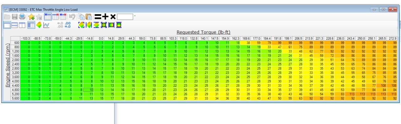

  19. May 24, 2020 at 11:54 AM
    #6459
    nd4spdbh
    Oct 7, 2013
    #114055
    14,621
    SoCal
    Interesting. above are stock NA values. 113* is definitely more than 115% of 84* max angle. I am assuming this table works in conjunction with the Optimum torque table?
  20. May 24, 2020 at 12:28 PM
    #6460
    OVTune
    Mar 27, 2017
    #214557
    8,112
    OVTune
    I'm not sure how or what is labeled in HPT, but there should be 2 of those ta bles
