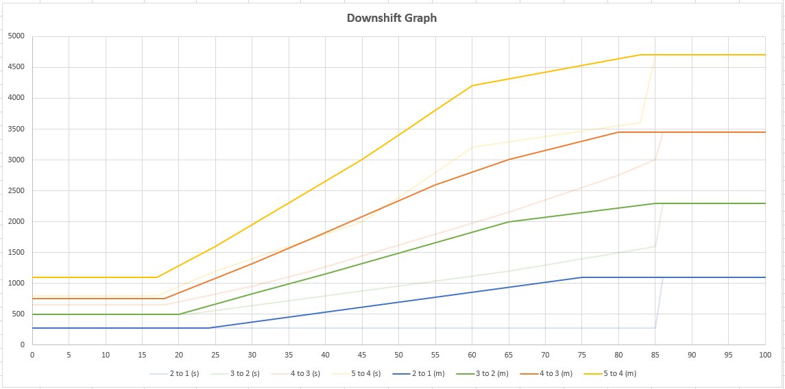

  18. May 26, 2020 at 3:41 PM
    #6478
    nd4spdbh
    nd4spdbh Well-Known Member
    Oct 7, 2013
    #114055
    14,595
    SoCal
    13 DCSB TRD OR v6 Auto
    Depends on what gear and at what speed.
    From Spicy Taco Sauce Batch 2
    Left (vertical) axis is DRIVESHAFT RPMS, not engine. Bottom, (horizonal) is accelerator pedal position percentage. Stock gearing is ~ 41 driveshaft rpm's per mph. so Imagine Cruising at 75 mph = ~ 3000 driveshaft rpms. You are in 5th gear at say 20% accelerator pedal input. Which with the above graph would need 45% accelerator pedal input to downshift to 4th if you were in 5th, and 65% to go from 4th down to 3rd at the same 75mph.
    That stated, sounds like your issue is on the upshift from 4 to 5 and it occuring too soon. Im whipping up a batch 3 of da spice, which will make the shift from 4 to 5 occur later (actually raising all upshifts and reshaping to try and make @snowsk8air2 happy :p)
