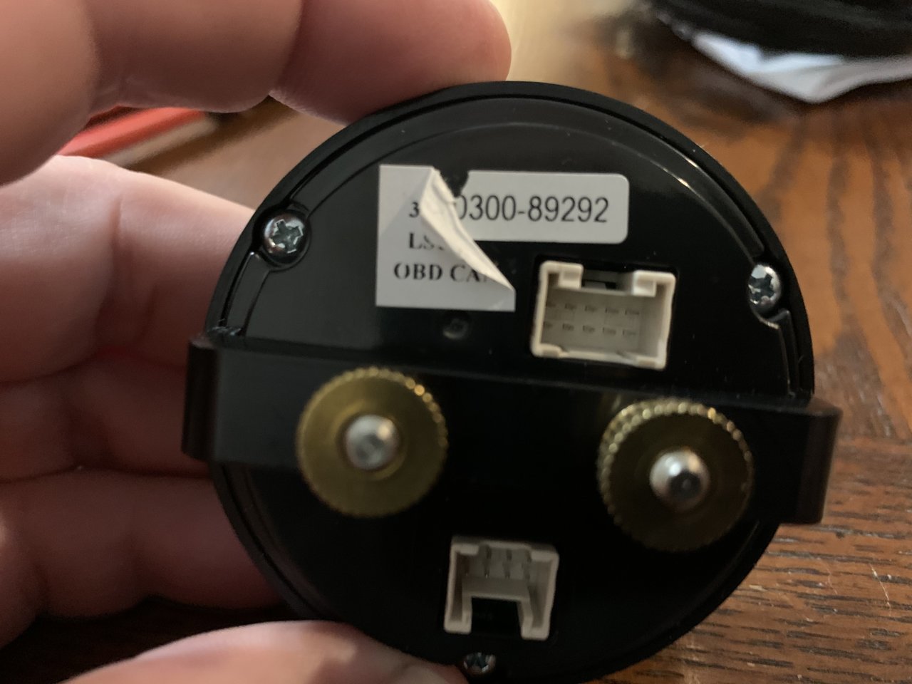

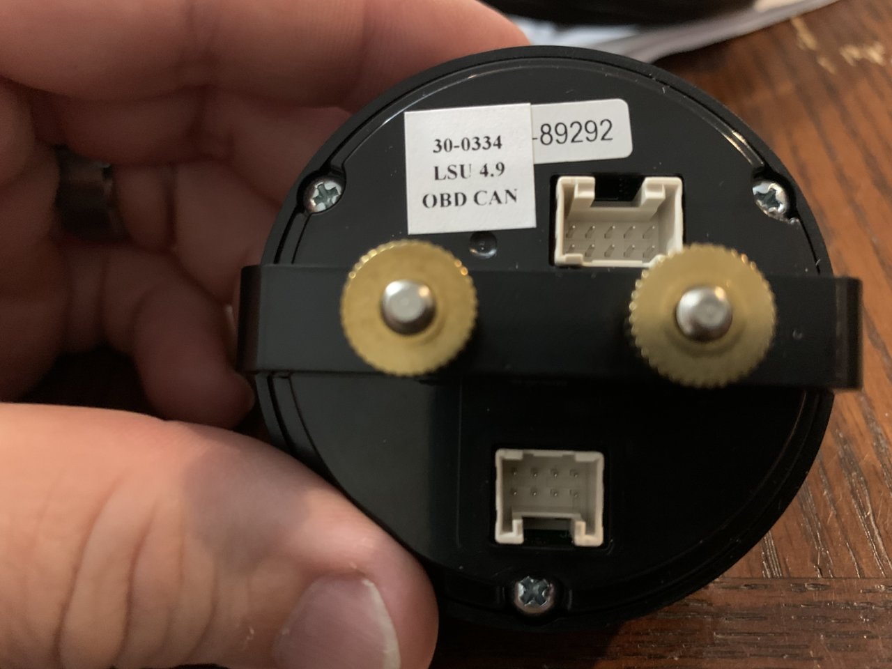

    This may have been discussed earlier in the thread and if so I missed it.
    PSA to anyone looking to add an AEM X-Series Wideband to their setup to log with HP Tuners OVER CAN BUS.
    There are a few AEM part numbers. That do CAN communication.
    AEM 30-0300:
    DOES NOT work out of the box for this setup. There is a guy on The HP Tuners forum that can flash a different firmware to the gauge to make it work, though. If you have ProLink, you can still use it that way, though without firmware flash.
    AEM 30-0344
    DOES work over CAN BUS
    The issue is that 0300 and 0344 have different CAN BUS protocols in their firmwares. The 0300 is meant to work with AEMNet device networks. 0344 is meant to work with OBD2.
    I did not know this initially and bought the wrong one. So now I have both models. :anonymous:

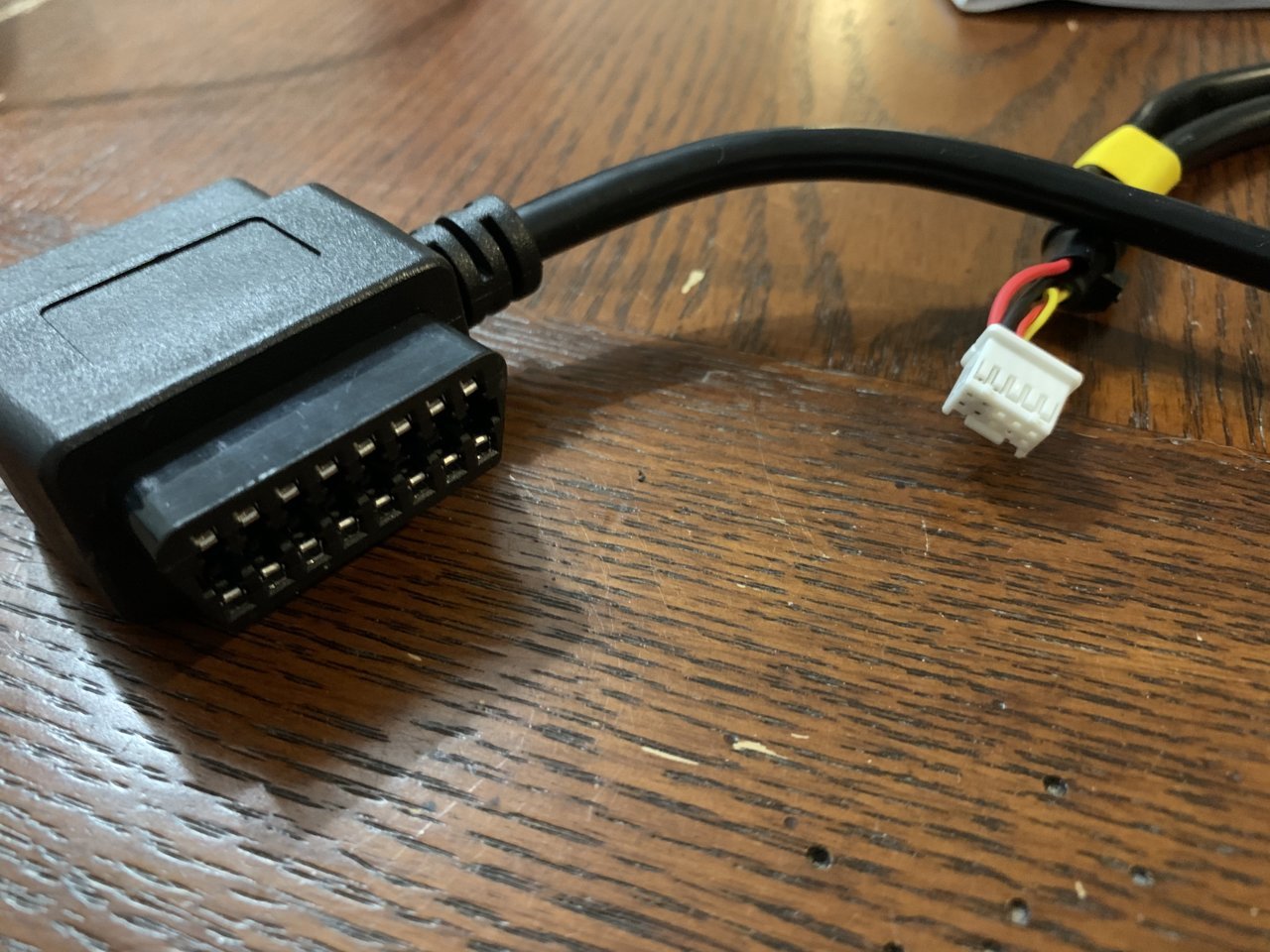

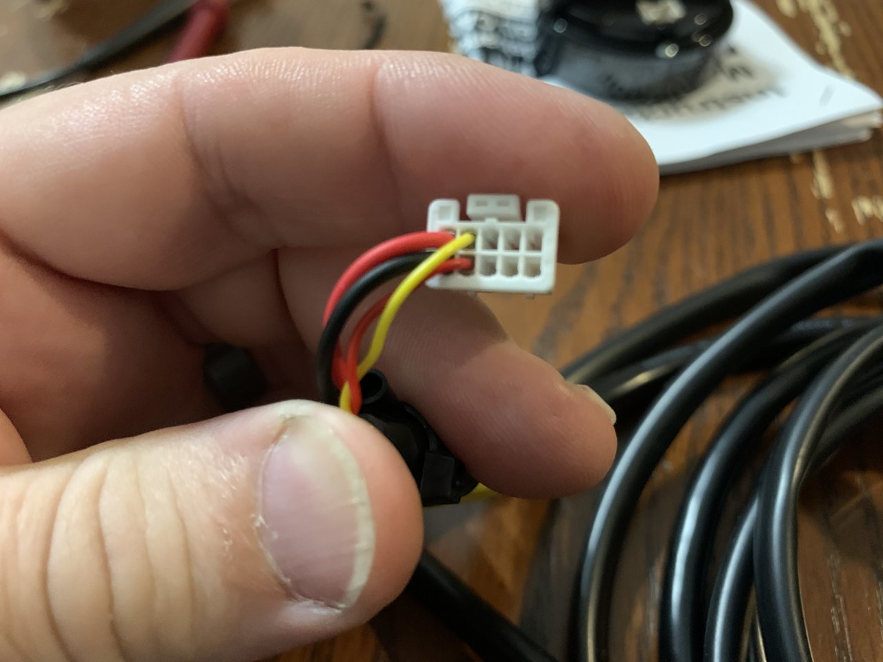

    Correct!
    The 30-0334 comes with an OBD2 adapter.
    But if anyone is like me, they don’t want an extra dongle hanging off the OBD2 port all the time. So as @Philby states above, you can cut the plug off and hardwire the cable directly into the factory wiring. Some prefer not to cut the factory cables and there are ways around that. But for those who ain’t skeered, these are the pin assignments.
    This is the connector at the gauge end. The colors may vary based on when the gauge was packaged. In my case here (thin gauge wires), the yellow goes to PIN 14 (CAN L) and the red goes to pin 6 (CAN H).
    The thicker gauge wires are 12v ignition (red) and chassis ground (black).

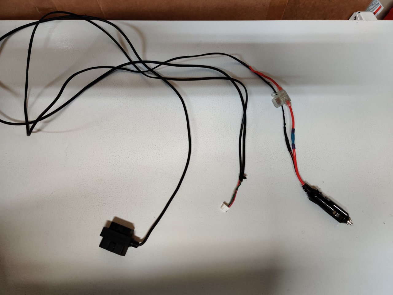

    Hey Loginfailed, Glad to see you got the new kit. As discussed earlier, I used gauge kit 30-300, that I bought a year ago along with the OBD2 pass-through adapter from a new kit 30-0334 I bought 4 weeks ago.. I did not send in my old gauge to get re-flashed and it worked so something is up. A couple theories I have are: A. AEM added the code to all the gauges from a certain point onwards, a few extra lines of code on a gauge that is sold in two different kits, saves time and more importantly money. B. AEM is pulling the wool over our eyes by not selling the adapter separately and insisting that 30-0334 is needed
    Just to be clear I wrote AEM and asked if I could buy the OBD2 cable for my 30-0300 gauge, they replied: "Unfortunately a 30-0334 is required if you are looking to communicate wideband data via OBD2 port." I took this statement to imply that gauge 30-0334 was needed to communicate via OBD2 but after I read into it, I saw where the same part number is used for the kit and the statement could also imply that I would need the kit to get the adapter. Hmmm?
    I believe the data is good, as without the correct code in my older gauge 30-0300, the software would not have recognized the gauge.
    I'd be happy to lend my pass-through adapter, once I get my tune done, out to anyone with an AEM 30-0300 gauge bought within the last 12 months to test and verify my findings.

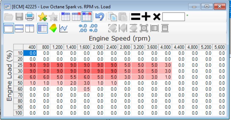

    Alright. Im trying to wrap my head around base spark and base spark limit tables and why they are the same? And if they are the same why have two tables?
    Currently trying to even out KCL values across load ranges at a specific rpm for more optimized spark and always found myself making sure both those tables were the same (just as they have always been in all the tunes, even stock) but wondering why it is.
    @JustDSM maybe you have some insight ?
    Also, high octane and low octane tables stock, these are the only difference in values, i would of figured the whole HO table would of been much greater than LO across the board, not just in a little area but maybe those are interpreted different by the ecu,

    The exact equation of how ignition is calculated is available in the toyota diagnostics? / repair / overhaul manual. Whatever it is called. 30k pages one.
    basically takes the most retarded value + compensations + KCLV +/- current recorded knock and derives a value from.
    some tables are used in very specific conditions, and the "high octane" "low octane" names are just a label, and I don't think it's entirely *accurate.*
    Check closely, why does the "low octane" table have more ignition in it?
    Because the ECU uses the tables, subtracts from each-other and all sorts of other non sense in the code.
    In the end it almost always uses the "base" ignition + compensations.
