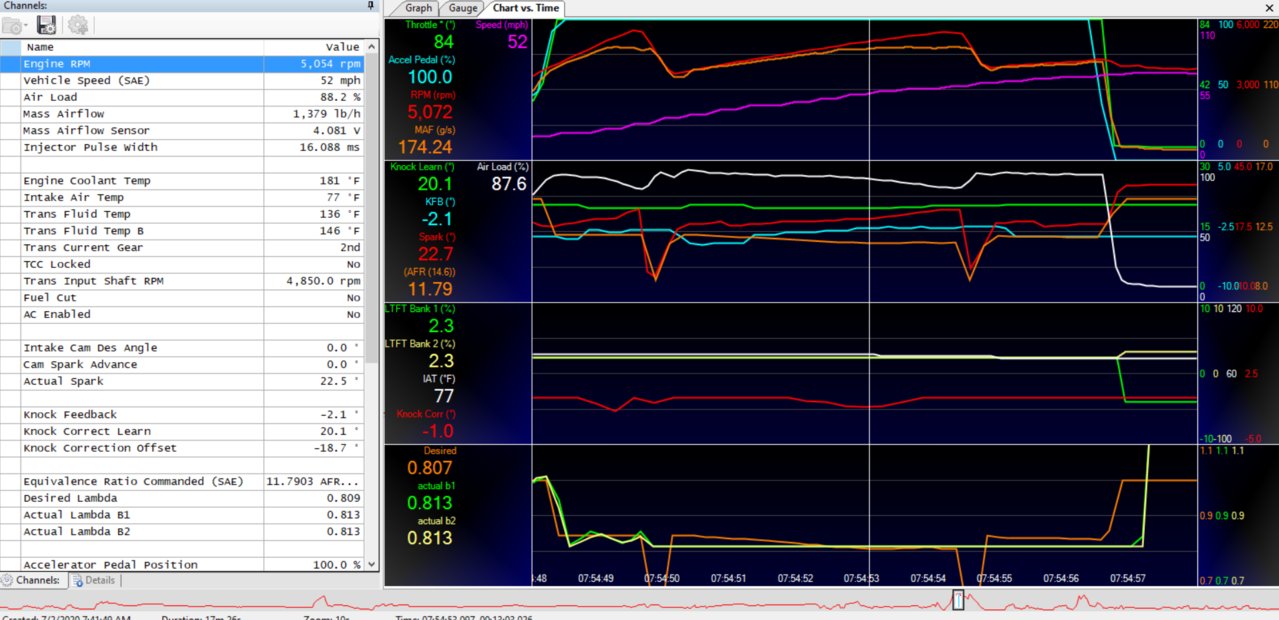

    Anyone have any idea why id be seeing knock correction even though knock feedback is above the -3 value?

    One of my knock sensors is tripping a CEL currently every time I drive for about 10 minutes. Not too sure if the sensor’s bad or what but my logs don’t show over 1* knock over the -3* baseline :confused:

    Yeah i doubt its a bad sensor no cels at all. Just curious how there could be actual knock retard going on, but have a happy > -3 knock feedback.

    Torque management.

    Ahhhh that would explain it. PM incoming.

    Tried something in my tune, with no help, still seeing knock correction but happy knock feedback. @JustDSM sent you a PM.
