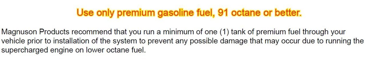

    The manual is your friend. Specific octane requirements are listed on pp 2, 5, 68, and 72.

    Yeah, drive EASY (not in boost) after you fill up with 91+ your current tank, run that half n half tank almost all the way through also driving easy, then fill up with a full tank of 91+.

    91 or preferably 93,94 octane. Wouldn't hurt to throw a octane booster in it till then

    Thanks for the manual! The manual that came with the truck is not for the SC.
    This morning filled half tank with 93 (now half 87/93). Will be easy on throttle for the next couple of fill ups. Getting STP Super Concentrated Fuel Injector Cleaner (will put this in today). This weekend getting/ putting in new spark plugs. Hopefully everything will be alright. Thanks for the help everyone!

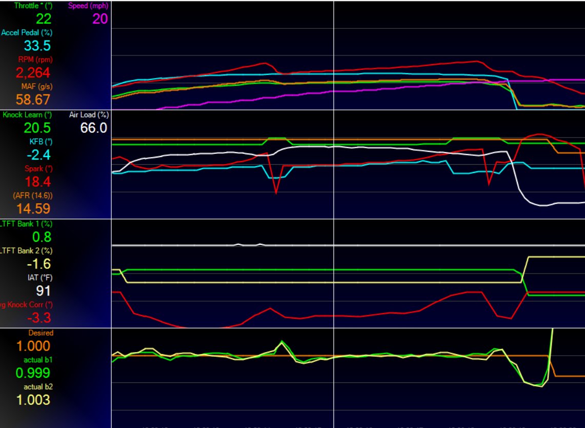

    Still trying to wrap my head around this,
    happy knock feed back, tons of knock correction
  8. Jul 22, 2020 at 12:40 PM

    It is my understanding that if you are trending knock ABOVE -4.5 then you need to remove timing. If you are below that and within the -4.5 - -2.0 range you should not make any corrections as you are within proper parameters of timing.
  10. Jul 22, 2020 at 1:49 PM
    #6690
    nd4spdbh
    nd4spdbh Well-Known Member
    Oct 7, 2013
    #114055
    14,621
    SoCal
    13 DCSB TRD OR v6 Auto
    for KFB numbers thats my understanding as well.
    But what im pointing out is how can i have 3.3* of knock retard happening even though knock feedback numbers are above the -3.0 default (happy) . This knock retard is adding fuel during Open Loop due to the EQ spark adder.
    Its just odd to me really.

  11. Jul 22, 2020 at 2:26 PM
    #6691
    1slow4.0
    1slow4.0 Be at Peace Brother
    May 1, 2016
    #185807
    220
    Nick
    Colorado
    2012 TRD OR
    Could it be the VVT map causing this knock retard? Just spitballing here....
    12TRDTacoma and nd4spdbh[QUOTED] like this.
  12. Jul 22, 2020 at 2:28 PM
    #6692
    nd4spdbh
    Oct 7, 2013
    #114055
    14,621
    SoCal
    Naw for all intents and purposes the VVT map is zero'd out. Also the VVT map if there was any timing changes would be added or subtracted irrespective of Knock Retard.
    Its my understanding the Knock Retard trumps all, so after all the calculations of KFB, KCL, base map, base limit, hi-lo interpolation etc etc (which i still cant figure out how the hell they are linked together), if the motor is sensing knock, Knock Retard pulls timing.
    It just really seems like these trucks due to their adaptive learning will eventually end up on the same final timing numbers regardless of what is put in the base/base limit maps. That stated, you can fine tune timing at various load's in the same rpm range so that KFB / KCL values are close so you dont get knock retard or a wandering KCL for a similar rpm.
    Hawk373 and 1slow4.0[QUOTED] like this.

    Yep I agree with the adaptive learning... I know Justin stated there are +/- of timing that goes on in the calculation that is unaccounted for. Possibly there is a table in the tune that isn’t defined yet. I’m curious on this as you are.
