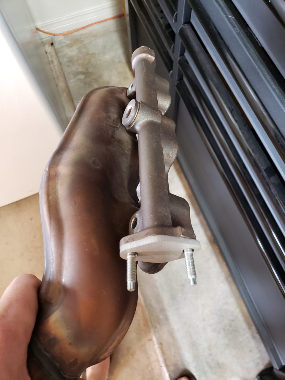

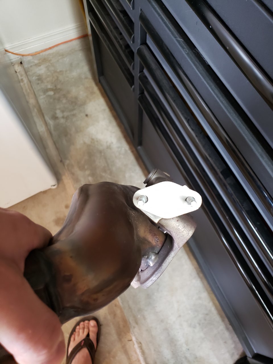

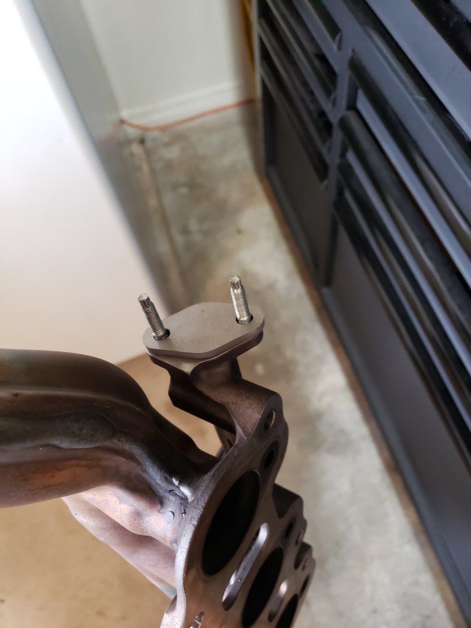

    Going to pick them up now with my @JustDSM / @loginfailed / TRD modded tune!
    Truck runs great initially but I will have to play with it. Review later.
    Block off info:
    $40 shipped to wherever priority mail sends it.
    PM me with full name and address and I will provide my paypal.
    Weeee.......this thread is breaking Tacomaworld speed records!

    What are the pro's and con's to the block off plates? @Roostfactor

    They're used in deletion of the SAI system on trucks equipped. Allowing the removal of hardware/plumbing related to the system, freeing up space and eliminating a potential point of failure that puts the truck in limp-mode for no good reason.
    Ultimately I'd say the truck is more reliable without that system.. But SMOG officials would disagree.
    That would be the only "con".

    I already have the 12-15 URD longtubes so I'll need a block-off, but wouldn't it be possible to install headers from a prior year Tacoma without the air injection tubes once the SAIS is removed? I'd think the headers should be the same minus that tube...then you wouldn't need a block off plate.

    I think that would be true as well. However, I already bought 12-15 URD headers so that is the deciding factor for me. Then you could probably get a prior 12 valve cover as well.

    Yes, I intend to install pre-SAI headers into my 2015 very soon, eliminating the need for the plates. However for those who already have SAI headers or manifolds these will allow you to delete that system without having to replace hard-parts you've already invested in.

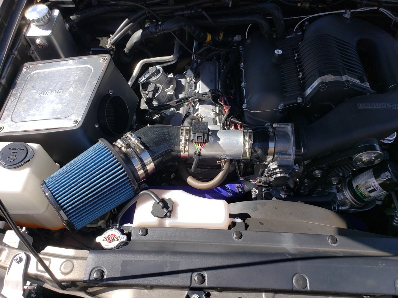

    Yessir! @JustDSM cal'd like @loginfailed.
    I started with @loginfailed's tune from a couple days ago. Huge shout to them for getting me up and running.
    Throttle map is awesome! Not jerky at all but much more linear than stock. It really makes it feel much more like having a throttle cable. Gone is the sluggish mid pedal response.
    I havent hopped on it yet, started leaning out a bit at 7 to 8psi. Things got better as ecu learned trims but I have some logging and tuning to do.
    I also slaved in my sc intake so I can tune for the intake once....unless we go with larger maf tube.
