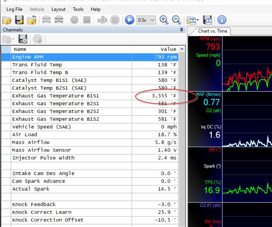

    OK, So I am on page 47 of what is now 341. Appologies if this comes up, I am trying to get through this entire board....
    Are all of the exhaust temps predictive from tables or do we have a direct temp measurement capability in HPT?

    They are predicted temps

    Safe to assume this is a bug in HP Tuners scanner?

    Most certainly

    no such sensor to measure that parameter on a gasser Tacoma. Not sure what it is measuring.

    Thanks for confirming, that's what it looked like. Anyone fit an RTD or thermocouple into their exhaust? I am interested in actual exhaust temps upstream of the cats. I suspect that there isn't an easy way to port a probe in with out drilling and welding a bung.
