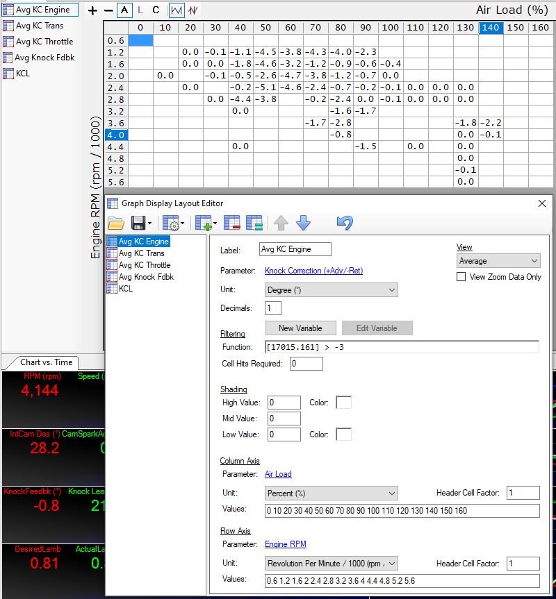

    On my truck, messing with the optimum torque table causes that 4-5 hang. I put my optimum torque table back to stock and it never hangs.
    I’m probably losing some power due to torque management, but the trans shifts so smooth and never has any hiccups. Whatever power I may have lost is minimal because I can’t perceive it on the butt dyno.

    Interesting. I have definitely changed the optimum torque table over the last few tunes. So I'll keep that in mind. Gonna try my v14 trans tune first to see if it helps

    I don’t have any proof yet, but I have a suspicion that when we make changes to the optimum engine torque table that we also need to make similar changes to optimum torque trans. I plan to explore that in the future.

    Potentially! Unfortunately those two tables are DRASTICALLY different in shape to begin with.

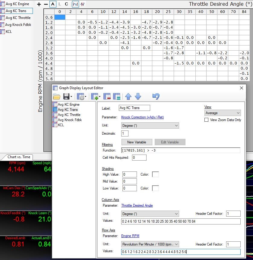

    That was my initial thought. How to convert changes from one table to fit the other table when they have different values in their axes. But, if you start with both tables stock, you can make a different graph for each. Do a log and adjust both tables at the same time according to what your graphs are telling you.
    Again, I don't yet know the relationship between the two tables but it seems like you would want to adjust both of them at the same time. My plan was to do an initial change of small amounts and test the outcome before going all in with it.
    Examples: Two graphs, same parameter, same filtering, different axes to match what is in the tune. One for engine (air load), one for trans (desired throttle).
    Engine
    Trans
