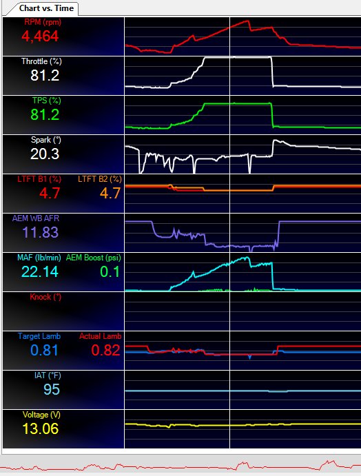

    I did a data log and I noticed that my truck is only useing 80% throttle in hp tunners is this normal ?????

    You mean, if you're at presumed full throttle it's only showing 80%?

    80-82% is WOT in hptuners. So assuming you mean its showing 80% when the pedal is to the floor that is normal. At least thats my understanding.

    Mine shows WOT at 81.2% Not sure what the problem is, they just don't want to max out the sensor to avoid error. Edit: I recall this being normal practice on my other Toyotas as well.

    I’d look at the actual throttle angle versus percentage. Keep in mind WOT is 84°. If you’re achieving and maintaining 84° at WOT your getting all the “sauce”.

    for fun today I may just take the intake tube off and see what angle the throttle blade is at.
    I know factory older Toyotas tps will never hit 5 volts inless the tps is advanced way to far foreword.
    and then stand alones are calibrated to show 100% at wot

    yup this. Look at throttle blade angle and accelerator position % the other TPS %'ages are all wack.

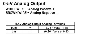

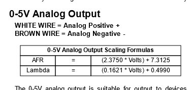

    On another note, has anyone made sense of adding analog though the pro-link? I tried adding channels using the user defined parameter and the math provided by AEM with ZERO luck or wacky readings. But if I select the 03x0 (WB) and 30-4406 (pressure) sensors that are pre-defined in VCM scanner they appear to work even though the formulas look to be totally different? What am I missing here?
    Scaling Formulas from the manuals:
    Pressure 30-0309
    Wideband 30-0300
    JacksonTacoma likes this.

    Here's how I did my aem afr (mine is a aem-4110). Don't have a boost gauge so can't help you there.
    Some of this you've probably done already.
    Add channel
    External inputs -->mvpi2-->pro link-->mvpi2 Pl a/d input 1 or 2
    Then left click on the new channel and choose transform-->user defined
    Then at the bottom I fudged the formula a bit to match my gauge as the recommended formula was off a bit
    Description: AEM-4110
    Function: (input/0.543) + 10.3 = output
    PhoS[QUOTED] and JacksonTacoma like this.
