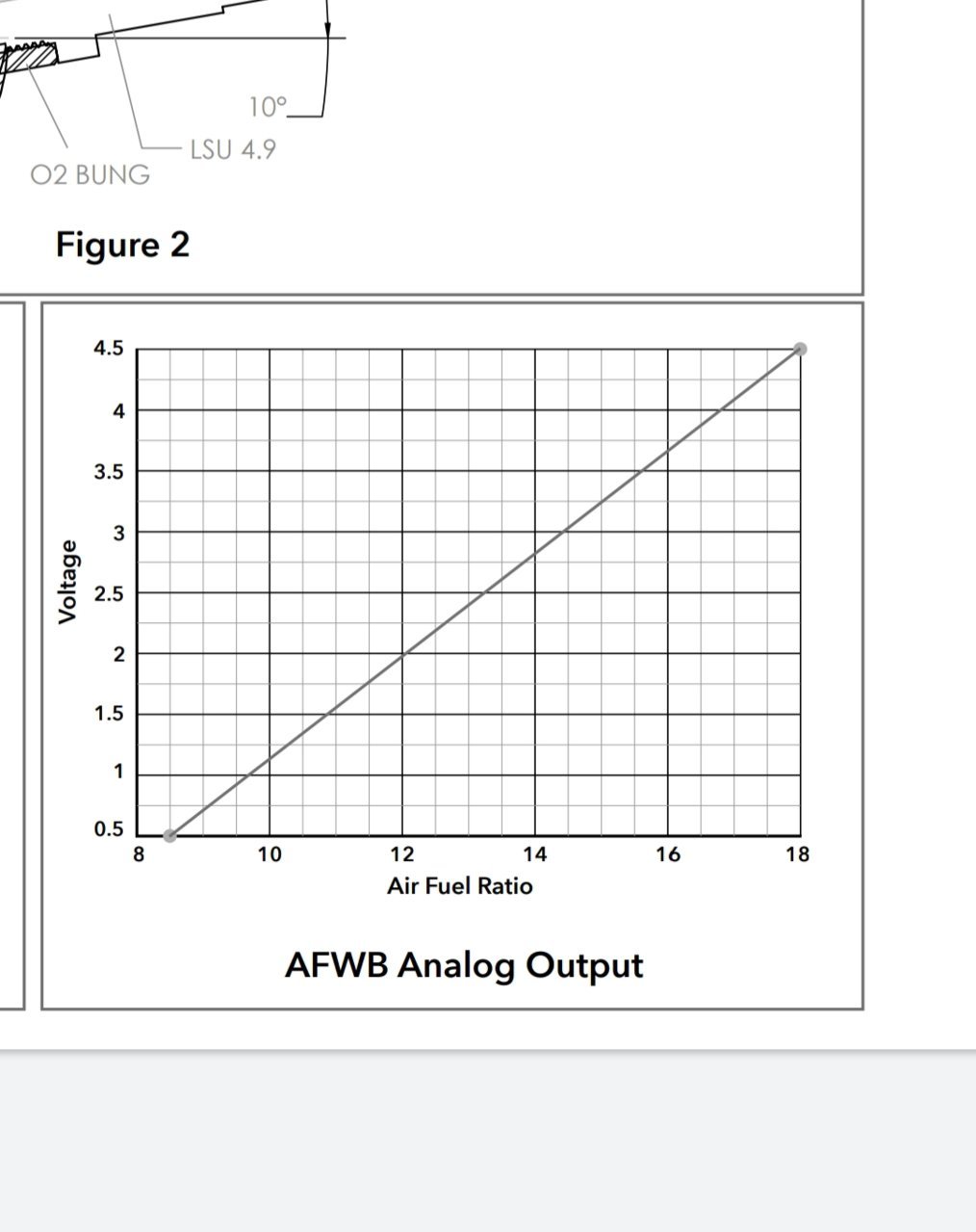

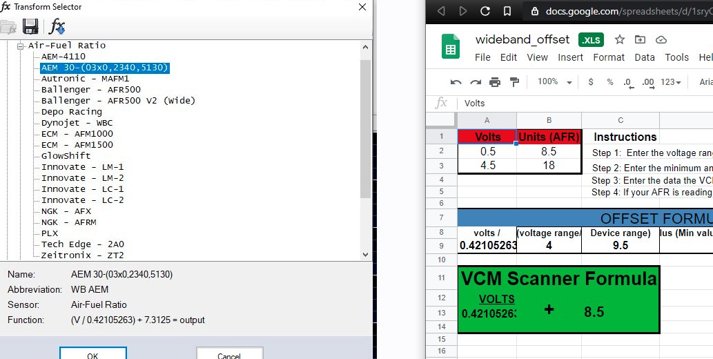

    This should help for those with oddball widebands not officially supported by HPTuners.

    Awesome. Thank you for sharing. Looks like your tool already has the speedhut settings as the default :)

    Yep, that's what I last used/saved. Can't recall whom I was helping..

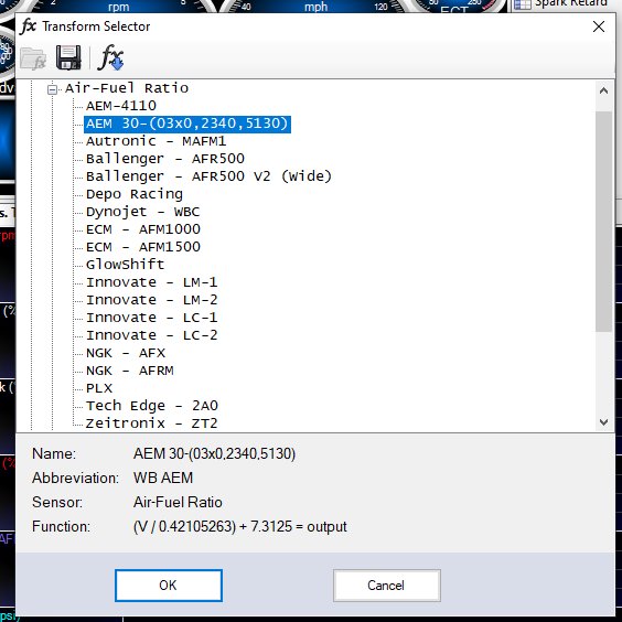

    It doesn't look to be far off the pre-defined values for the AEM WB I tried in VCM scanner. That explains why this setting looked very close to what my gauge was saying. Not sure what to do about the boost side, still need to test more. Kinda silly this math doesn't transfer over?
