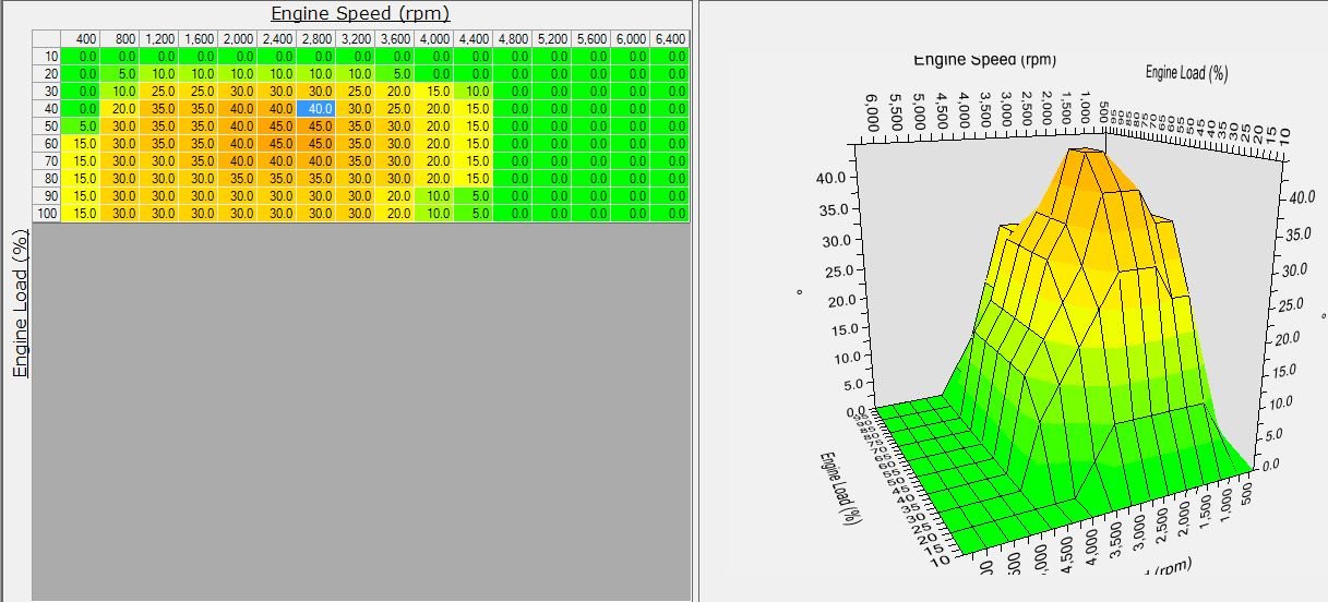

    @JustDSM
    Any reason why the vvti base table as far as angles are in 5deg steps when the table will allow for smaller increments? (To allow for a smoother table)

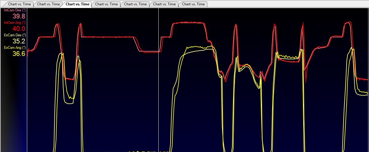

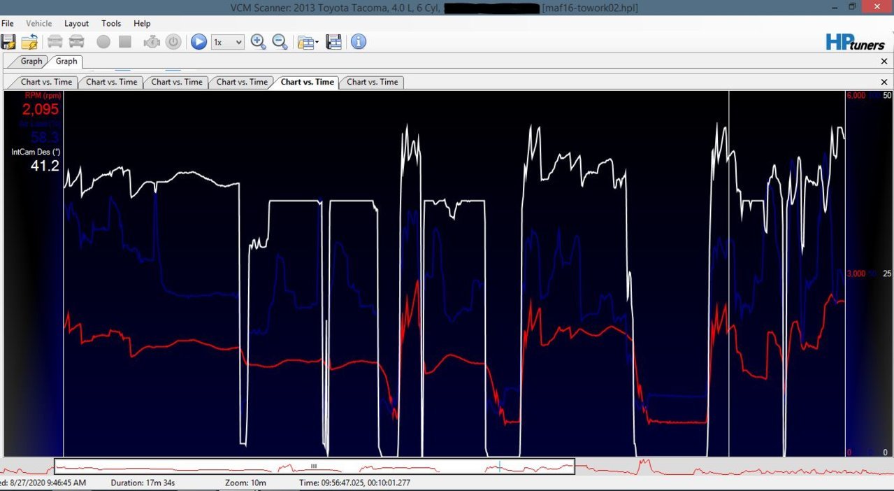

    Lets take a peek at a log from your truck. (maf16-towork02)
    Here's birds eye view of the system operation. The VVTi mapping is RPM/Load based (with some TPS input..)
    Depending on the lens in which you use to view or analyze your data through, you could draw a few conclusions.. One of those might be "those cam angles are all over the place". Perhaps leading you to want to smooth them out? ;)
    And its possible that some degree of smoothing might be useful or helpful even. But I think it's important to still keep a broad view here. Look at the RPM. Look at the Air Load values. What I see here is a engine being operated in a dynamic environment with varied RPM, Load AND variation in the requested torque of the engine.
    In other words, this is a capture of a highly dynamic (yes, even for us low level N/A guys) environment where we have the mechanical limits of the engine being pitted against variable conditions in which the vehicle is operating in, and the highly variable driver input and his/her requested torque. This highly variable and dynamic environment is one of the reasons that lead to VVTi's creation. Static cams are optimized for a specific set of operating conditions. The VVTi system and any other continuously variable cam timing system allows the torque output of the engine to be broadened across its operating range. Most of this you and the others here are probably well aware of, so forgive the D- history lesson on the history and operation of these systems :)
    But the point I wanted to drive home was that just because you see variability, does not not necessarily mean you have smoothing that needs to be done. So we can see what the system in operation is requesting of the intake cam phaser, lets take a look at the actual map that made the above possible.
    As can be seen, the map used to create those jagged lines above is actually quite uniform and smooth.
    OK Justin.. Get to the point!!!
    The question.. "why not use smaller increments".
    It's not that you can't. The biggest reason is, a change of 0.3deg of intake cam advance is going to have virtually no measureable effect on torque output. It's probably also worth noting that the cam angles we're requesting and subsequently logging are the DESIRED cam angles. These things do have error, which is why we have the proportional and integral feedback corrections. We don't currently have the ability to log the actual cam angle versus the desired angle, so to demonstrate I'll use a log from my Mustang (which obviously has much more support).
    Aside from having dual variable cams, you can see that the designated cam angles aren't always exactly what you get. There is always some error in the system and just one of those reasons you get some "run to run" variance.
    Ok Justin.....
    In short.. You can smooth the map if you wish. If you're doing it for more torque, you better find a good load bearing dyno and spend a good bit of time and money doing some steady state tuning. You'd really be splitting hairs at that point or are competing at the highest level to warrant that time/expenditure.
    My question earlier? All you're really changing by smoothing the map is changing the RATE of change in the cam timing. Toyota mapped the VVTi pretty well. The basic structure of the map is sound and while there's some to be had with adjustment, their just isn't much reason to map the VVTi system down to 1/3 of a degree. When driving (aside from stead state freeway cruising) the load on the engine varies and the requested torque changes are sizeable in terms of total available torque. Even from a casual take off and acceleration, we're using a sizeable chunk of the available torque of the engine. To best ensure the requested torque is met, the engine needs to make "gross" changes to the cam timing to keep up with the demand. It's also important to remember the system interpolates values between cells so the cam is quite fluid in its movement already.
    Hopefully that helps some.. :) And I didn't even touch on airlfow...
