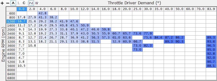

    It only occurs at a little higher in throttle angle (IE getting on the freeway), and will hang even when backed off. Im guessing around 40-50deg of throttle blade angle based on some logs where im getting on the freeway
    If you are just cruising around town (under 55) with no slightly faster than normal taking off then its fine. But getting on the freeway under moderate acceleration it will go into 4th lock up and wont get into 5th at all unless you force it with the shifter D4D pattern. It also has no problem with WOT runs to highway speeds (75mph) then letting off it will go right into 5th lockup.
    I went back to essentially v12 4th n 5th gear shifts for my test case v15 and still had the same hangs, hence why im thinking its something with the optimum torque table as thats whats drastically changed between days of v12 and current.

    Until I can get my 'idea' sorted and a more efficient means of implementation, try this for me. (This is for anyone who has the shift-hang issues)
    Leave everything else alone and copy/paste the stock Optimum Engine Torque table back to stock values while running v14 trans tune. If it cures the issue, I can almost guarantee what I'm working on will cure the hang.

    Figure out where you are at during this time on your 3D Trans torque map and raise the values.

    Tested last night! Initial impression was very positive. Revision two sent back late last night and testing being done today. I suspect It’ll lick the problem based on the round 1 improvement.
    The histogram I posted above is the ticket to figuring out what value the Optimum Trans Torque value should be. The stock trans torque table is quite far off.. Coincidentally right where the 3-4 and 4-5 take place (among many others) but suffice to say, initial feedback was quite surprising to the tester.
