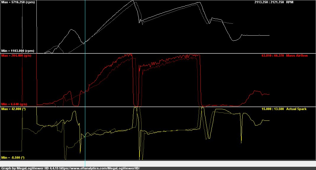

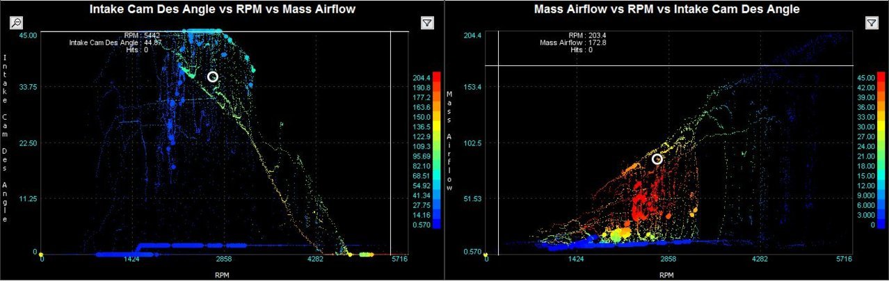

    Did a thing today.. Went out to log of my current tune (87Octane) and then reloaded a modified version of the stock tune w/ my throttle mapping.
    Thought it would be interesting to see "what's changed".
    *Brighter colors are my current tune, muted colors being 'stock' tune*
    Interesting to see the rate of acceleration difference along with the amount of additional airflow with a more conservative ignition mapping than OEM.
    I also really like the Scatter plots!
