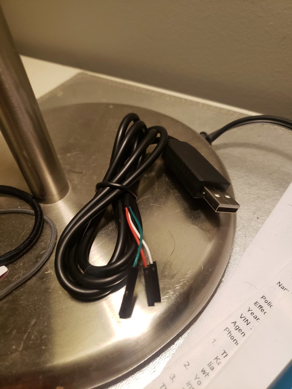

    Does anyone recognize this cable? I swear i thought it came with my mpvi2 but it doesnt make sense. And im pretty sure it didnt come with my aem wideband

    Also @Sacrifice my mpvi2 did not come with such connector, that may have came with your gauge I would check the install book and see if it shows a parts list that is included with the gauge. Honestly the non usb ends look like what you plug into a pc motherboard for the power on/off, reset, hdd light and power light. But never seen 3 attached to a usb before.
    Sacrifice likes this.
