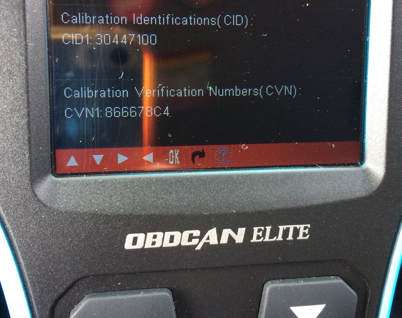

    If i can plug in the MPVI2 to get this info then yes.. or if an enhanced ABS/SRS code reader would work i have one of those. Otherwise i don't think i'd have the ability to pull the cal

    An advanced code reader should be able to, the one I am using in that pic is a cheapie $25 one from napa

    Ill try plugging mine in when i get home to see what i can find
