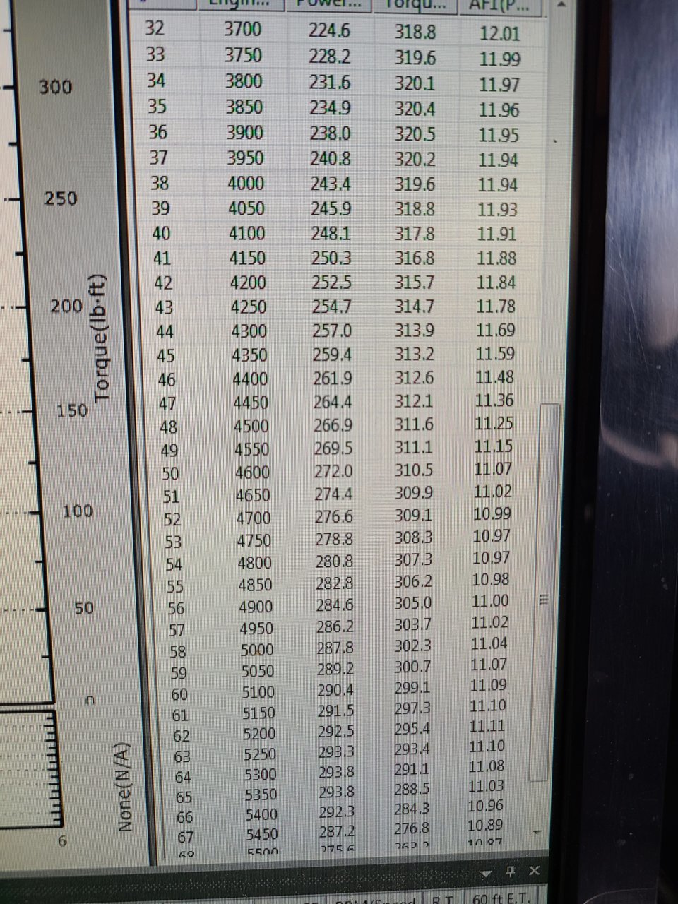

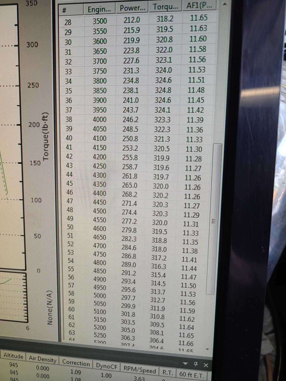

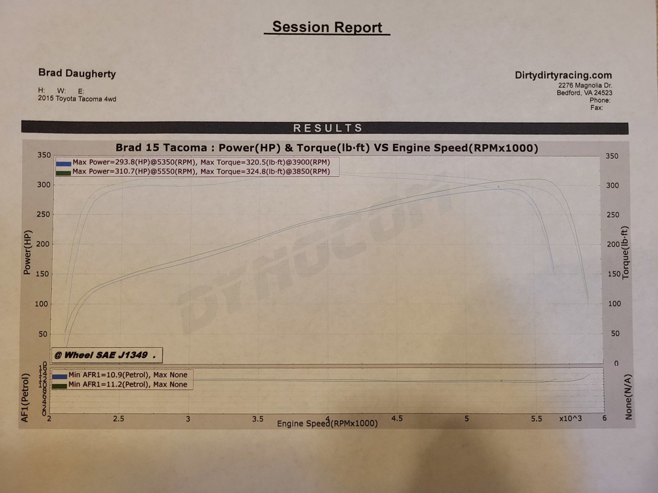

    Posted this in the dyno thread, but since it pertains to @JustDSM and his HPTuners tune I felt it should be in here as well. Made a dyno run on the TRD tune, and then another after the HPTuners tune. No other modifications were made so this is strictly a tune comparison. Current mod list is in the first post of my build page here.
    https://www.tacomaworld.com/threads/my-slow-2015-build-thread.387762/
    Disclaimer: JustDSM said my truck was running leaner than most with the TRD tune, so he had less room to play with the numbers. Therefore I would believe that sets my gains as a low baseline.
    End result: 310.7whp and 324.8wtq. So a gain of 16.9whp and 4.8wtq from the tune alone. Gained hp and tq throughout the entire rpm range, but had the biggest gains between 2.5-3.5k rpm and above 4250.
    With the tune my a/f ratios are actually safer up to 4.5k rpm (they were around 12) before going rich, and now sit right around 11.5 throughout. Can't complain about having a safer tune while also picking up some extra power!

    A/F ratio comparison between the TRD tune vs HPTuners/JustDSM's tune. This does a great job of showing how little he had to work with, and how well he stabilized the ratios throughout.
    HPTuners/JustDSM tune

    @nof555 thanks for the dyno post - impressive numbers
