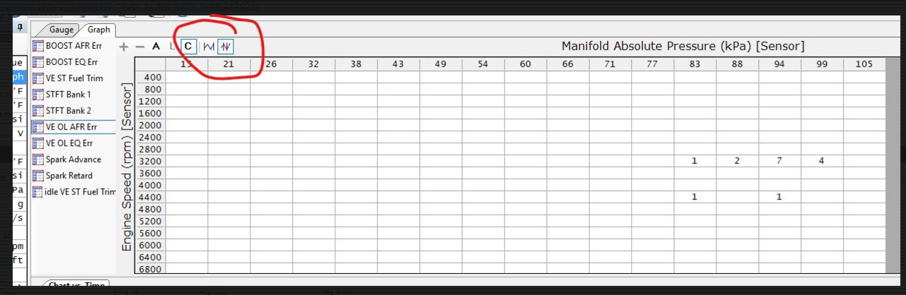

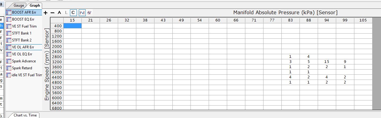

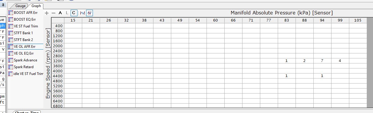

  14. Aug 11, 2021 at 11:39 AM
    #7534
    Sacrifice
    Sacrifice Motorcycle Goon
    Oct 8, 2013
    #114093
    16,071
    KS
    DCSB OR 4X4 LT
    Pelfreybilt Front Bumper,BAMF sliders, Airflow Snorkel,Mini D2S Retrofits, ADS Rear Shocks, Deaver U402 Leafsprings, 35s, AllPro +2LT
    has anyone else had an issue between zoom/all data? my counts dont match up at all even if i zoom all the way out
    edit i hate how graphs/charts are labeled backwards
      File size:
      77.9 KB
      Views:
      106
      File size:
      79.8 KB
      Views:
      94

  17. Aug 12, 2021 at 9:59 AM
    #7537
    nd4spdbh
    nd4spdbh Well-Known Member
    Oct 7, 2013
    #114055
    14,621
    SoCal
    13 DCSB TRD OR v6 Auto
    The counts are probably being filtered. You can swap axis's pretty easily within the chart settings, just a lil copy pasta.
    Also unless you added a map sensor on the v6... there isnt one, honestly i dunno how its getting that data.
  18. Aug 12, 2021 at 10:26 AM
    #7538
    Sacrifice
    Oct 8, 2013
    #114093
    16,071
    KS
    DCSB OR 4X4 LT
    Pontiac gto ls2 ;) i do have filters on my histograms but the counts shouldnt change between zoom data/all data if i zoom out to see the entire datalog
    I meant physically labeled by hptuner.The true graphs (imo) is the lines vs time. But thats labeled charts. The histograms are labeled graphs but i think it should be labeled charts
  19. Aug 12, 2021 at 11:23 AM
    #7539
    nd4spdbh
    Oct 7, 2013
    #114055
    14,621
    SoCal
    AHH ok that makes more sense. I believe here is your problem
    Your only looking at counts for the section visible on the line chart area.
  20. Aug 12, 2021 at 11:28 AM

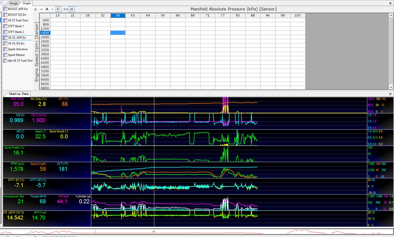

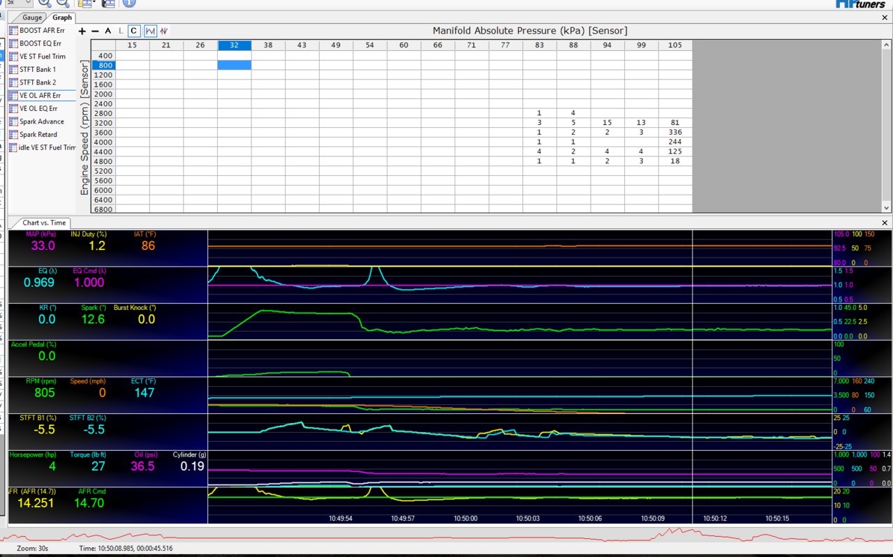

    #7540
    Sacrifice
    Oct 8, 2013
    #114093
    16,071
    KS
    DCSB OR 4X4 LT
    nope. heres a few more screenshots.
    1st : all data
    2nd: zoom data but zoomed so all data should be captured...
