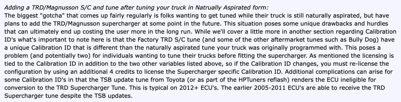

    My name is Neil, I live in Nevada and I have a 2015 TRD Tacoma. I have been lurking on here for as long as I have had the truck, but this is my first post/question. I have been using HPTuners on the Taco and my Suburban starting in 2019 so I am very familiar with the program.
    Anyway, I just bought the Magnison Supercharer for my truck and I am having an issue with the Bully Dog tuner that it came with; its basically stuck in an update loop. Like I said, I already have my ECU unlocked from HPTuners for the NA setup; is there anyway to get the base tune file for the supercharger to reflash my ECU with? I know this has been probably been asked a million times already; but there are 382 pages to go through and this is all that is stoping me from finishing this project.
    Thanks in advance for any info.

    Pretty sure Justin can reflash your ECU with TRD Tune and get you going. You just need to mail him your ECU. Let me look for the link to his new handler.

    This is covered in my FAQ: https://www.tacomaworld.com/threads/hptuners-the-tacoma-faq.705981/
    You're going to need a replacement ECU that does not have the TSB update and 4 more credits.

    Well that is good to know, and one hell of a "gotcha" moment. So my truck is dead in the water, great... Guess I'm driving the Suburban for a while.
    Is there a sticky or a walkthrough on how to fix this problem? I did a quick look and prices for a unit are from $60-$600, yikes!
    "Pretty sure Justin can reflash your ECU with TRD Tune and get you going. You just need to mail him your ECU. Let me look for the link to his new handler." --I am guessing this isn't an option either? I noticed you sell tunes, but it sounds like the ECU would have to "stock" and still have the Call ID?
    I had a feeling this was the problem. I veguly remember reading about this back in 2019 when I unlocked the ECU. But that was like...3, 7, maybe 12 years ago at this point, I don't know; time is hard these days.
    Anyway, thanks for the info and pointing me in the right direction.

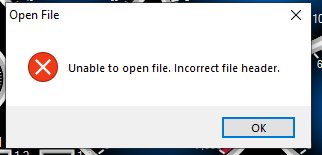

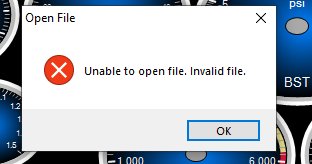

    Has anyone had the following errors with VSM Scanner Version 4.10.7?
    "Unable to open file. Incorrect file header."
    "Unable to open file. Invalid file."
    It seems random. One file will be fine and the next has an error. The issue started in the middle of December. I probably need to open a ticket with HPTuners, but I may be missing something simple. Any feedback is appreciated. Thanks.

    I was Beta and had to upload the latest Beta version and it resolved everything.
