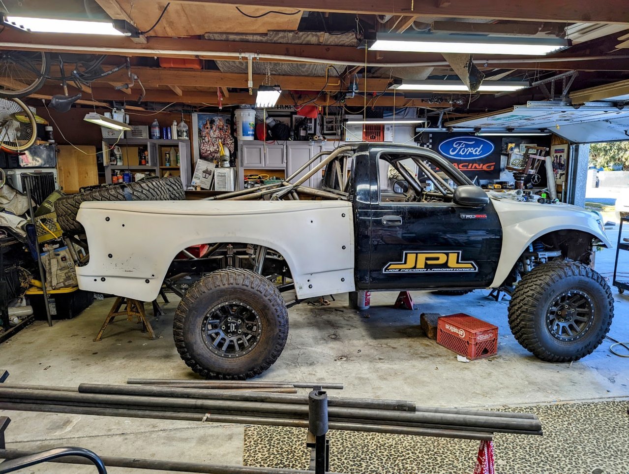

    street legal race truck.
    I just want to get one season out the tranny to get the truck dialed. Not looking for years of use. Would be happy with 500 dirt miles and 1500 street, motor and tranny only have 32k on them. I know the engine should be solid forever if it's anything like my old 3.4 powered race truck, thing lived on the rev limiter and didn't care.
