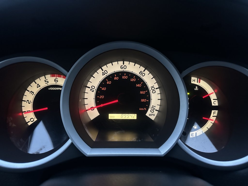

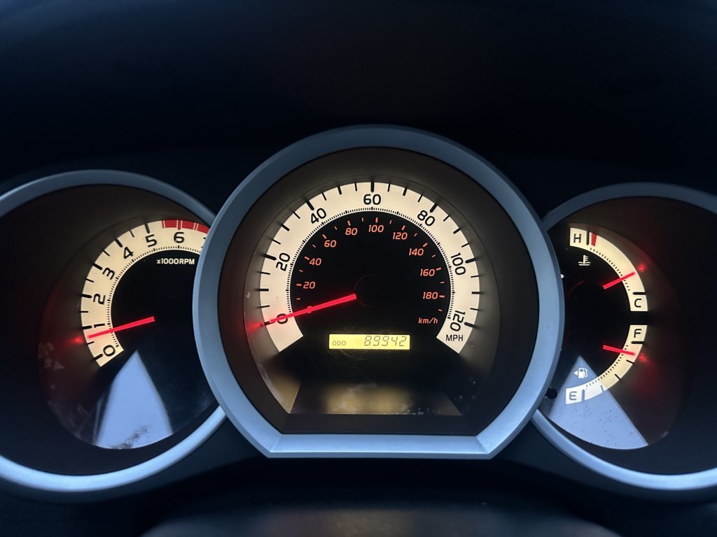

    2nd gen auto owners, what does your truck idle at?
    I'm thinking mine is low for some reason now.

    2015 TRD O/R.
    1st pic is in PARK.
    2nd pic is in DRIVE.

    Thanks. Mine is definitely lower in drive now. Think it's closer to 550-600 rpm
