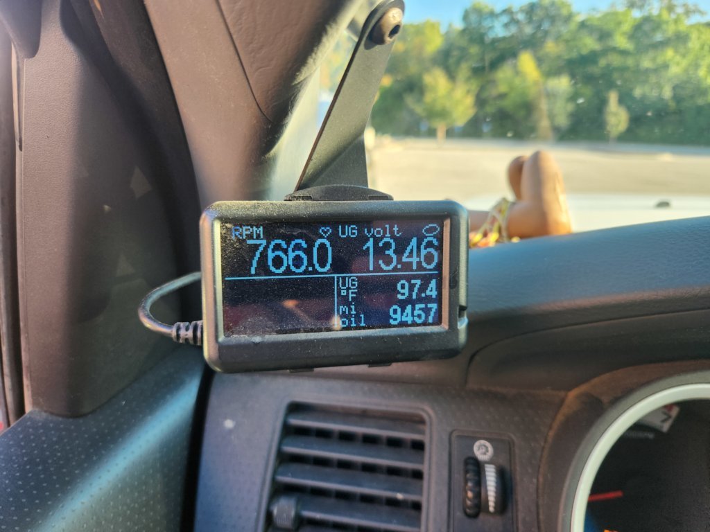

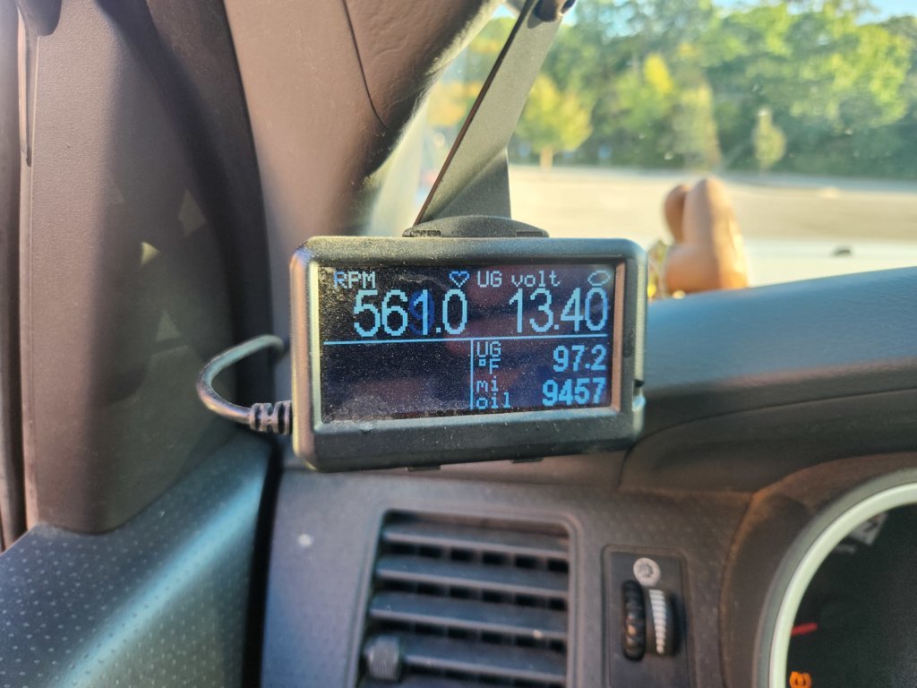

    Nope seems to run fine otherwise. Just gets to that low rpm idle and it's noticeable to me. Probably not to her.

    Just means it has eco-mode now at idle!

    My FJ (same engine) idles anywhere from about 550-600ish as well. When it drops to 550, it doesn't stay there too long and will eventually jump back up. I've actually been trying to pinpoint a certain sound I have at about 550 rpm lately, and only at that rpm. It's this odd almost purring/vibration sound. No exhaust parts are loose, and it almost sounds like it's in the dash.

    I see similar dips to ~500 RPMs as well. At one point there was an adjustment to the MAF scaling that helped. That is all as desired now so I may have a mechanical issue. There should be the ability to adjust an idle screw on the throttle body. But that may be a band aid. I would like to confirm the "throttle position relearn" and the "Idle relearn" that is referenced by many others. Does the process truly make adjustment to our trucks? Does running the TRD with HPtuners calibration interfere with that? Does the truck relearn on its own? I assume the FSM would define these conditions.

    Sounds normal to me. My truck idles 600ish warmed up. If it was lower/higher than intended you would get a P0505 code.

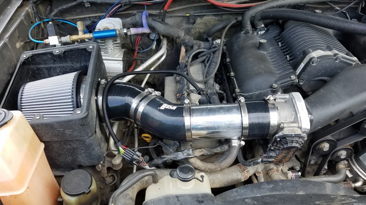

    Kel, I’ve got an identical AFE air cleaner on my truck. I’m going to start taking things apart soon, ditching the 7th injector and installing a 76mm tb and 3.5 maf tube like you’ve got. Would you mind sharing the tubing sizes/or part numbers you used to build what you have here so it fits the airbox? It really would save me a huge amount of aggravation trying to figure out what to get o_O:thumbsup:
