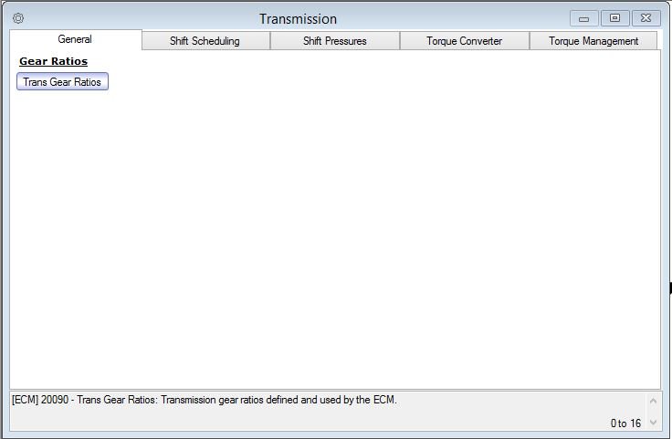

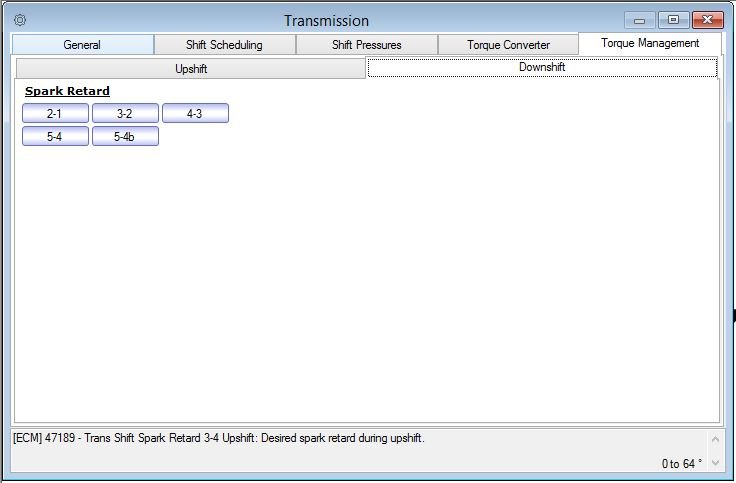

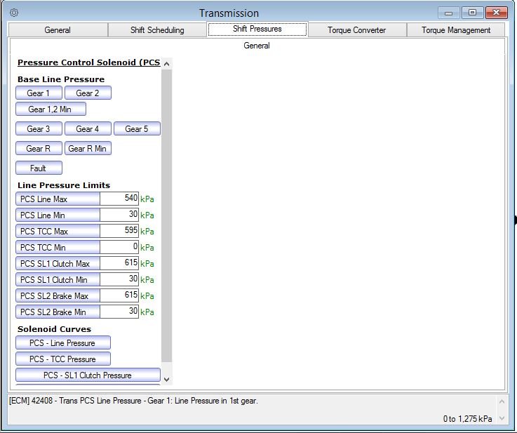

    I've got updates! I've gotten ahold of a 2011 4.0L Auto Calibration and have screenshots of the transmission tables. See below:
    eljedi68, Franks96ce, tsb and 5 others like this.
