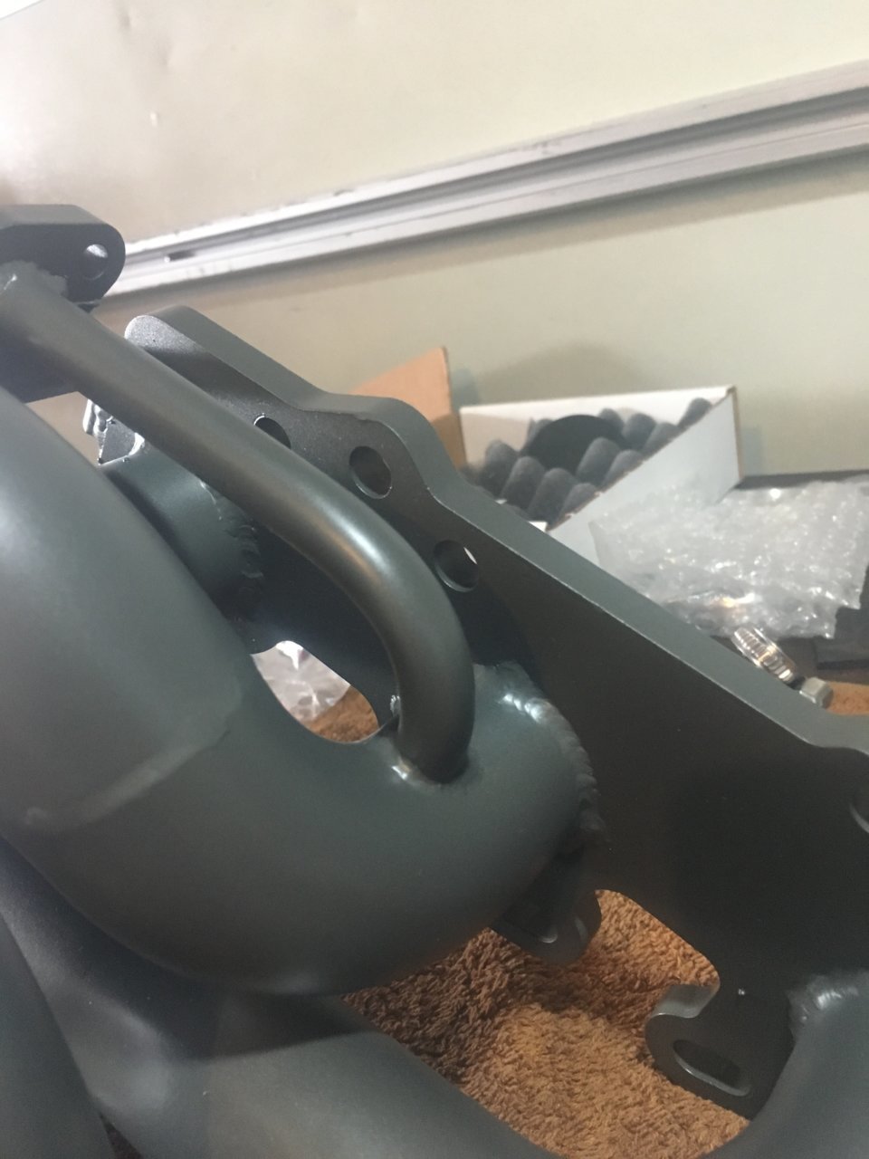

    I am thinking just cut these off and MIG it closed in lieu of block off? I don’t have TIG capability. They are off anyway. Doesn’t seem tough to reach just worried about clean and not disrupt flow inside.

    You can. Of course you would lose the ceramic coating from that area.
    You can grind any irregularities from the inside after your done welding.
    Block off is safer though.

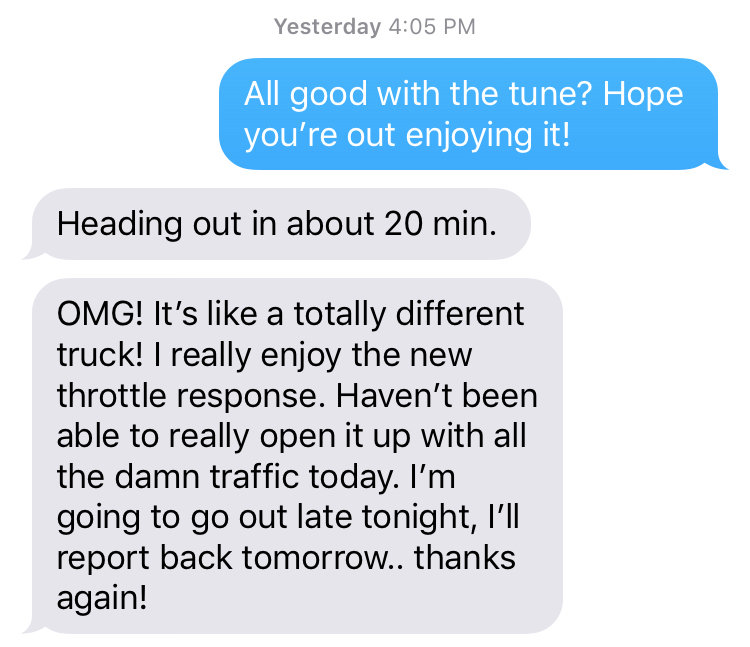

    So is there any benefit getting one of these on a bone stock 1GRFE? This thread seems to cover the sai subject but I don't see anyone talking about what kind of HP or driveability or mpg gains you can possibly get out of this tuner

  17. Apr 14, 2019 at 1:51 PM

  18. Apr 14, 2019 at 1:57 PM

    Shaeet
    Shaeet Member
    Jul 22, 2018
    #260118
    9
    Gambrills, Maryland
    2012 Blue Tacoma TRD OR
    Bro, thanks so much! That screenshot of a text message explained everything to me (and everyone else)
