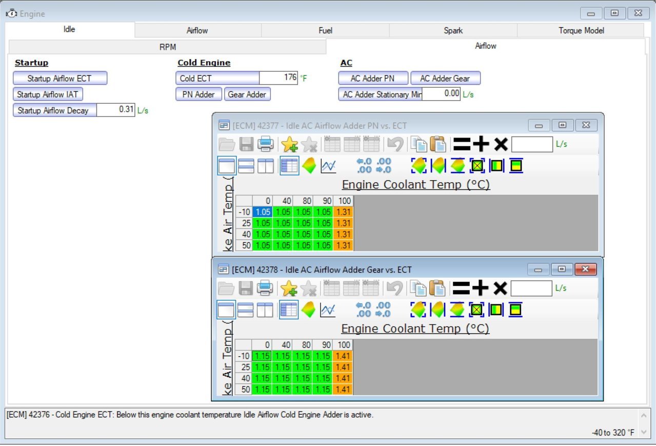

    Idle stays the same with ac on or off.

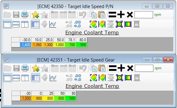

    Idle rpm can be set for park and in-gear.
    Lots of stuff coming! It just takes brilliant minds to bring all the variables together optimally.
    You know....fueling, timing, vvti timing, etc. Noone has even messed with the trans settings yet that I know of.

    @Roostfactor , so is the ac idle issue a programmer limitation or a local issue on your truck?

    There are a couple different ways to mess with idle speed. There's base idle and then theres A/C adder as well IIRC.

    This is a 2012 4.0L Auto Idle speed target

    I dont have any idle issues. I'm simply saying idle doesnt increase when ac is turned on. It stays the same and goes to the target idle in the table. If it didnt then of course idle would drop when the ac compressor kicks on.

    A/C airflow adder

    Sorry I thought you were saying the idle doesn't increase when you turned the a/c on and that you were increasing the base idle to compensate.
    Yeah, that's great to be able to have full control like that! thanks for the screen shot.
