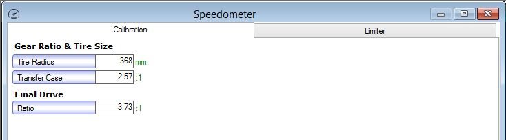

    I thought I read earlier on in this thread that the mpvi2 could recalibrate the speedometer for larger tires and different gear ratios?
  4. Apr 17, 2019 at 1:01 PM
    #1144
    JustDSM
    JustDSM Oderint Dum Metuant
    Jan 16, 2015
    #146525
    3,270
    Justin
    Ogden, UT
    It can. Using this entry

    I measured and updated that entry but it did not appear to adjust my speedo. I will double check my math but I jacked up the truck then wrapped a string around the circumference. 2(Pi)r to get my radius converted to centimeters and adjusted my final drive ratio of 4.88:1.
