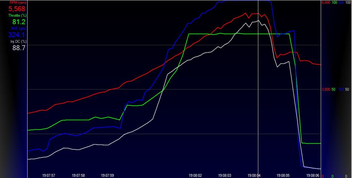

    Looking at that graph. Seems You would want bigger injectors if they are at 89% IDC especially at 81% throttle.
    Why does the throttle flat line?

    The way this reads, 81% Throttle is actually WOT.

    Since it flat lines guess that makes sense for WOT

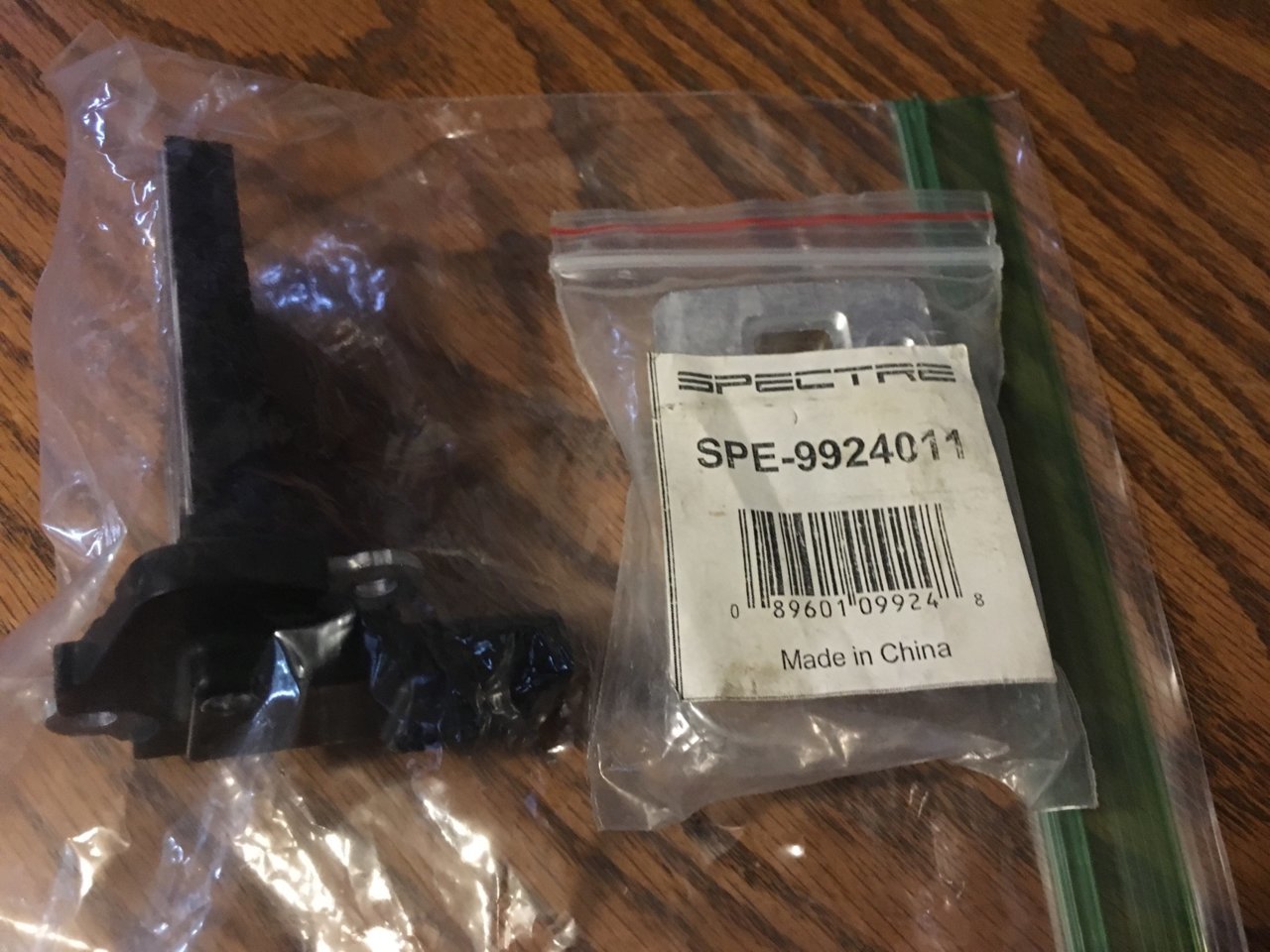

    I removed my MAF, cleaned with CRC MAF Cleaner and stored a couple months ago when I installed the Haltech. I never welded the flange in, plans obviously changed. I’ll part with both $57 shipped.
