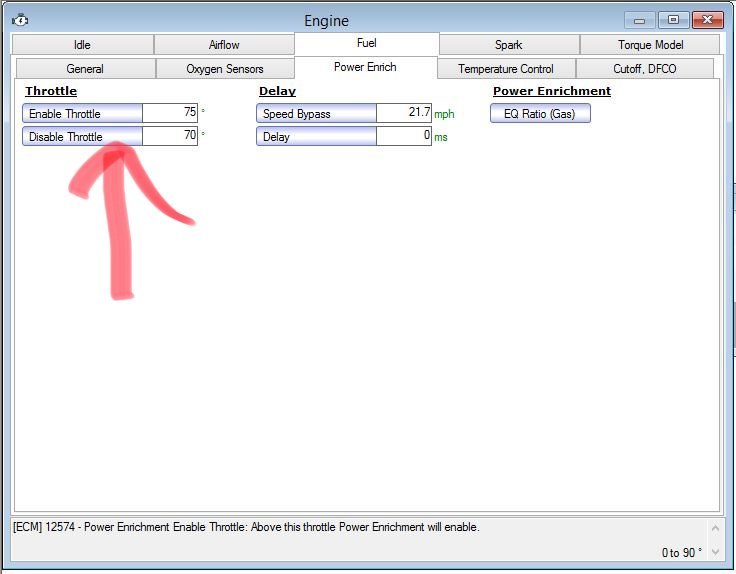

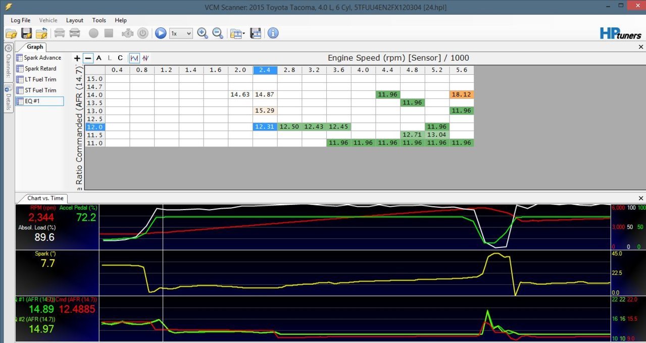

    From what I can see, not exactly. It's related to the fuel mapping. From what I'm seeing and how the ECU is behaiving for me as of this moment, the fueling strategy Toyota chose for this application is not like a traditional 3D table where you reference RPM/Load on the axes and specify a value that ultimately corresponds to a given injector pulsewidth.
    With the currently defined tables, it appears Toyota has adopted a fueling strategy that essentially tries to keep the truck at a stoic AFR unless you're really hammering on it for emissions/efficiency purposes. I think this is what might be causing you forced induction guys some issues.
    So what I'm seeing is the open/closed loop transition point is not yet currently defined. Here's a screenshot of the VCM Scanner (logger) which is also still very much in it's infancy, thought once you get the hang of it, it's much more friendly and usable than Techstream.
    In the datalog of a 2nd gear pull, you'll see the timing drop significantly at the beginning of the log. That is the vehicle switching to open loop.
    Bringing this back around to your original question and where I was going.. The fueling strategy used on the N/A 1GR Single VVTi tunes is based off of a Power Enrichment EQ. Essentially there's a table that has a RPM axis and corresponding multiplier to literally command the ECU to target a specific AFR. The values you reference are the throttle positions where this Power Enrichment EQ table is applied. Stock values are 70deg. This means the N/A calibration essentially shoots for a stoic (14.7:1) AFR unless it's essentially floored.
    Hopefully that makes sense.

    That makes sense. So those 75* & 70* values are in reference to throttle angle in degrees, not percentages. I noticed in the electronic throttle tab it has a value of 84*. So 84* would be floored?
    Roostfactor and JustDSM[QUOTED] like this.
  19. Mar 31, 2019 at 7:54 PM
    #119
    JustDSM
    JustDSM Oderint Dum Metuant
    Jan 16, 2015
    #146525
    3,273
    Justin
    Ogden, UT
    Correct! The definitions are using setup in degrees for accelerator position and throttle. The max throttle opening would be 84deg (though I'm only seeing ~80-81deg). Need to check my Weathertech mats aren't restricting my go-pedal..
