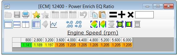

    Here is the Power Enrichment EQ table I mentioned: **Note these values are not stock, do not run these values in your truck**

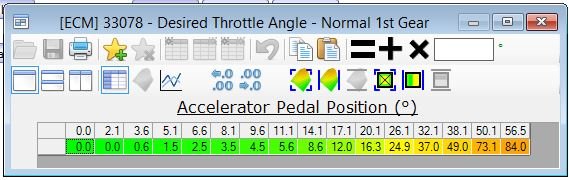

    And here is the throttle opening vs accelerator pedal. This is 1st gear, but they're all the same for 1st-6th including reverse.

    So is the 1.141 like a multiplier when in open loop? Is it something like LTFT x 1.141?

    Could you essentially customize the response curve of the accelerator pedal by adjusting this table? Similar function to what a pedal commander would do?

    Ok that makes more sense.

    14.7/1.141=12.89 AFR
    And not necessarily openloop, it references the Throttle angle defined in the tabled you asked about earlier.

    Yes you could customize the response curve of the throttle relative to the accelerator with these tables.
