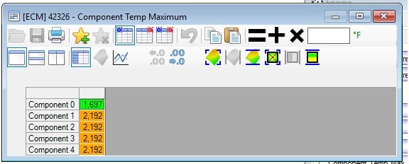

    Starting to poke around a bit in some of the tables. Anyone got a clue what Component 0 is? I'm assuming 1-4 are the catalytic converters, curious what the fifth component is?

    I asked HPT about defining what they are specifically, but I'm pretty certain 0 is the WRAF's.

    Any chance it’s the target temp for the heating elements upon startup?

    No sir, that's for the overtemp protection circuit. Basically a map where the ECU literally dumps upwards of 30-40% more fuel over base tables to cool the exhaust components during high load/rpm. ie: why the TRD and N/A tunes are so damn rich.

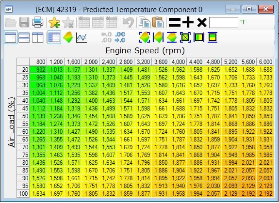

    The exhaust temp is determined via this map for component 0. Other maps for other components.

    Interesting thought, but I’m more apt to think WRAF due to their importance in fueling.
    And we all know the SAI failures are occurring a little to frequently. On top of that, if they’re failing with COT enabled at that temp already, further richening the motor to increase service life is going to kill your mileage and neuter any hope you pick up the benefits of an appropriate AFR. Not to mention introduce more carbon to further complicate matters.
    Not at all saying your wrong, but that really makes me ask why SAI was a necessary addition..
