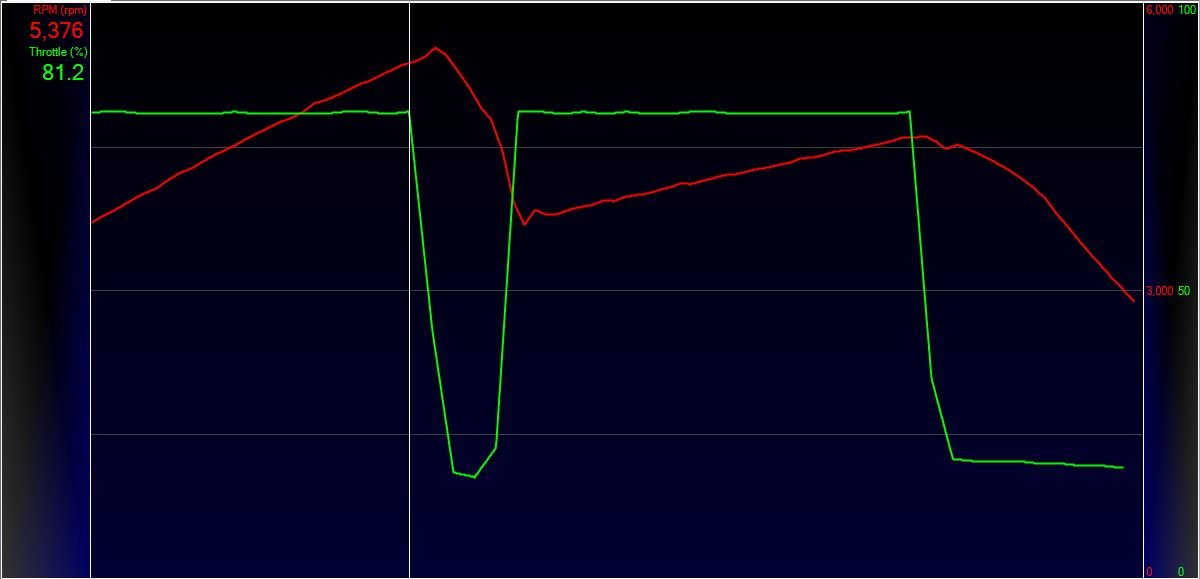

    Since my truck is AT, I've never experienced the rev hang. What exactly happens or when does it happen?

    TRD Supercharger, TRD exhaust, Leather seats, running boards removed (why it came with them I cannot imagine), Salex organizers, BAMF behind-the-grill light bar, Rigid SR-20 and SR-Q - Spots mounted behind stock grill, color-matched grill, WeatherTech FloorLiner DigitalFit floor mats, Tech Deck, Avid bolt-on slider/step converted to weld on by TW member Achirdo, Diaz Fabrication Model T, Icon Stage 4 with OME Dakar rear leaf springs, OME Driveshaft spacer, Toytec 1" Front Diff Drop, FN BFD 18"x9" GMG Wheels, BFG KO2 285-65-18 tires, Ultragauge mounted above mirror, Tuffy Box lockable storage, MattGecko rear window security bar, Relentless Fab tailgate protector, CSJumper 700 lumen flood pattern back-up LED's, modified BeeRadd under-hood lighting with two KC Cyclones; KB Voodoo cargo management system and standard rails, AllPro hi-lift jack mount, 48" hi-lift, RCI Metalworks aluminum front skid, Flyzeye 3VP-RS in glovebox and console, AFE CAI, Coupe fuse box cover, battery hold-down bracket and CAI air-box cover, Wurton pod led's installed as bed lights on Lowbrow Customs motorcycle fork brake line aluminum brackets, Pop-n-Lock PL5400, Extang Solidfold 2.0, Rechelon Retro's, Moromoto LED fogs, URD Y-pipe, Walbro 255lph fuel pump, Speedhut AFR and Boost gauges, Cravenspeed gauge holder, CMC by Tandem Automotive, 70mm throttle body, CSF radiator, Doug Thorley shorties, Vibrant 7101 cats, SOS Offroad front and rear bumpers, Smoothflow 2.5” SC pulley, Steeda SC belt tensioner, roostfactor belt wrap kit, switch Pro 9100 in custom Tandem Automotive holder, IPT overhauled transmission, FIC 650cc injectors, HP Tuner, entire engine overhauled by Engineered Performance, Alvarado, TX.
    Do you get the 4-5 flare? Not as bad with the new VB, but if I manually shift I get it.

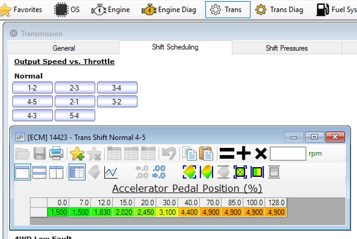

    It is strange. I did not have the 4-5 flare running the stock ECU with the UCON. As soon as I switched to TRD flash it immediately started happening. It only happens at lighter throttle positions. I was able to minimize it by adjusting the 4-5 shift scheduling. I thought it was gone for good, but it happened once today. Still not as severe as it was before though.
    Compare this to your table and you can see what changes I made:
