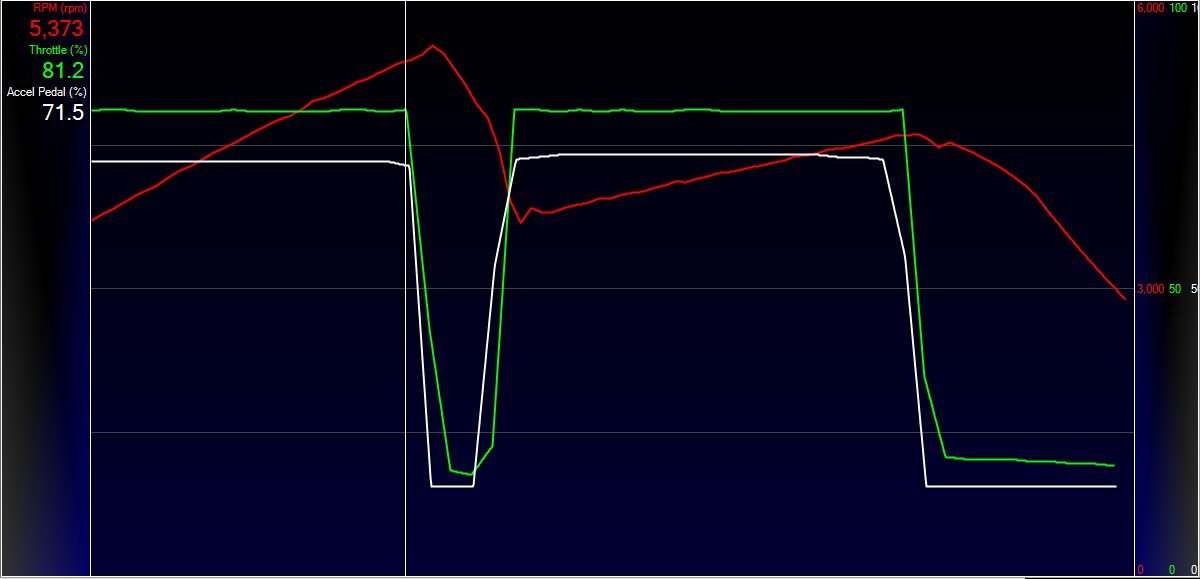

    Does it only happen at speed? Not at a stop?

    Between every gear.

    It's a computer commanded increase in throttle in between shifts for manual transmission equipped trucks.
    It's a GM thing, they were the originators of that crap.

    I'm seeing the throttle close (green) and tracking pretty closely to the pedal (white). Through it does appear there is some delay/decay. It was my thought and what I brought up to the HPT engineers, was there might be some delay/decay table that hasn't been defined. We'll see..
