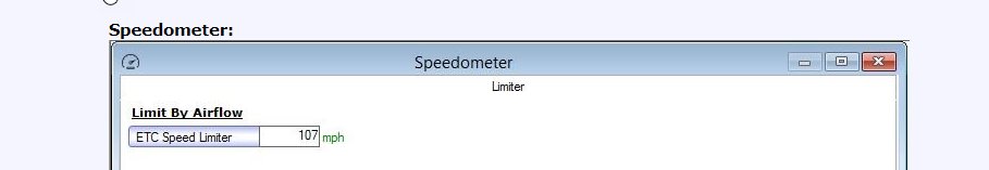

    Does this mean what I think in that us auto trans guys can adjust the speed limiter on the dyno to hit redline in 4th gear?

    Yep! You can set it to >300mph!

    I hadn't thought of that but it certainly looks like it!

    This just keeps getting better and better. Always wanted a 300mph Toyota. :burnrubber: LOL.

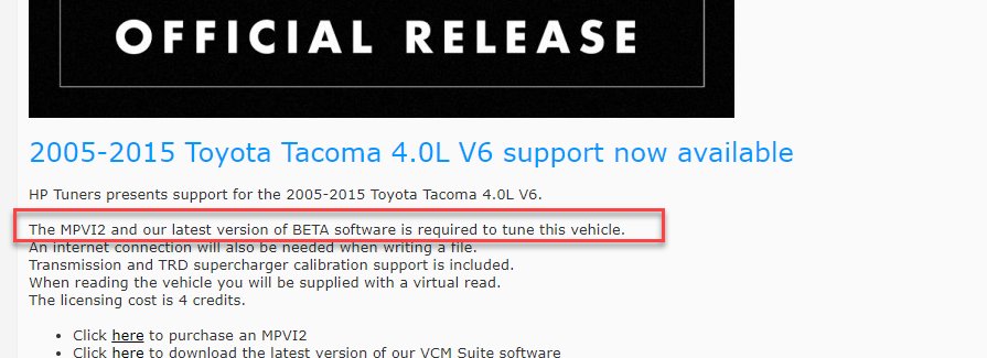

    Since this is still in beta testing phase, has anyone seen any info or talked to HPtuners about what the end goal is for the beta testing? I'm curious whether that means they just want to see more user results or if they are planning further development. At what point would this be done with beta and made "official".

    I think it is already official.
    https://forum.hptuners.com/showthre...ering-2005-2015-Toyota-Tacoma-4-0L-V6-Support

    That's a great question, and one I can't answer.
    I think I can at least go out on a limb and take a stab at it though.. Looking at other supported applications the ECU's are very well documented/defined giving the end user access to virtually every single parameter within. I can show you what a fully supported application looks like versus what we have currently, and while we have the basics available to us at this point, there's still a lot more to be unlocked. It's going to take a little time and ultimately show them the demand is there to move our application up the priority list. If only 2-3 of us use this (exaggeration..) we're not going to get what the other applications get.
    But to your question.. I think we'll eventually see a fully defined ECU package where you virtually have full access to every possible parameter.

    I gotcha!
    What you're seeing is the VCM Suite software which consists of the editor and scanner (logger). The map/table/etc definitions for each ECU calibration are defined in the VCM Editor software. HPTuners has had the ability to flash the Toyota's since the MPVI2's release, but they had not defined the maps/tables/etc that you see in the screenshots I posted. Until these maps are defined, there isn't a way for us to tune the truck unless you're a software engineer type.
    So the beta release of the VCM suite has the basic tables/maps for the Toyota's defined, allow us to tinker.
    Getting to a fully supported state would be along the lines of my previous post. Ie: a fully defined ECU.
