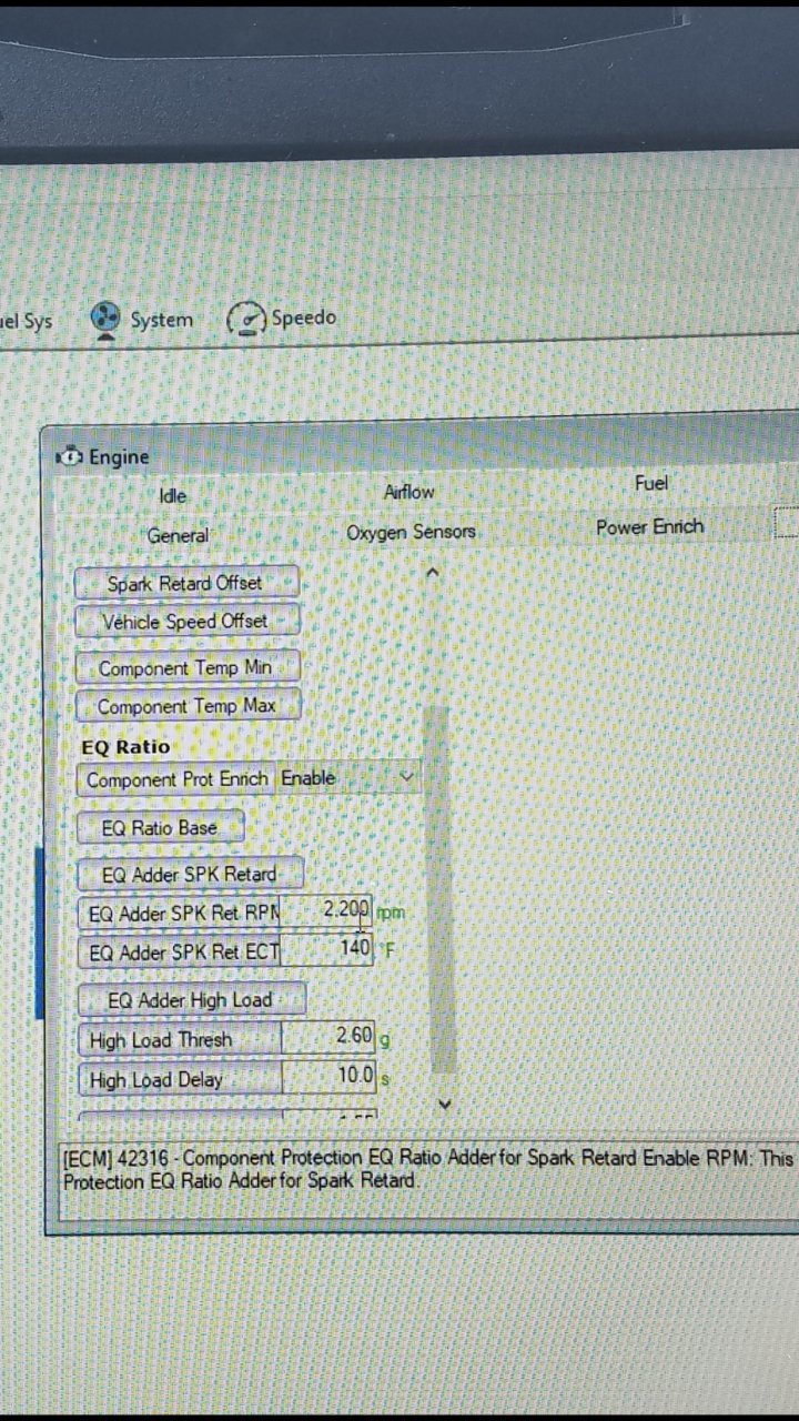

    For when I'm running on off-road courses and im using my exhaust that has no catalytic converters at all.. Which one of these settings do I change to remove the cat over temp protection that wastes fuel?Screenshot_20190421-145111_Gallery.jpg

    EQ Component Prot Enrich > Disable
    Be aware however you will have to dial down PE values to values less than 3/4 pedal activity in order to compensate for how stoich the tune will otherwise want to be at all times under cruise and during throttle modulation.
    05Taco4x4, TodayWasTHeDaY and JustDSM like this.
