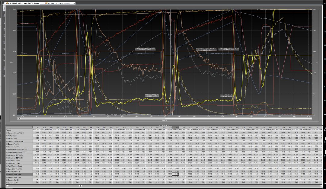

    Good to have another datapoint on the UCON fueling ability. Do you or any of the other guys running the UCON have the ability to get a datalog of a single gear pull? I've got some futher questions, but we'll take that to PM since it's not really necessary or relevant to the discussion here..

    @BassAckwards could you send me a single gear datalog when you get a chance?
    @JustDSM, what gear do you want?
    I also may be able to send you a copy of utune arch which is what we use to view the datalogs. If not I, or @loginfailed will have to interpret the data you want.

    You mean like a steady 55mph where im not shifting?

    I don’t need anything crazy. Say a 2nd gear pull from ~2000RPM. If you can get it from a manual truck that would be ideal, but a log from an auto will work.
    If you can get me the software that would be great and make it easier to poke around, but a screenshot would suffice I believe.

    sent you an email buddy

    @BassAckwards has a UCON, manual, larger injectors (if installed), smaller sc pulley, full headers/exhaust and a few other goodies. That's why I tagged him your request.

    You are wanting a WOT pull correct?
    @BassAckwards has a bunch with multiple gear pulls. Will that work?

    I have a 2nd thru 4th gear WOT pull i am about to send @Roostfactor for you. Should be some good info in there for you. I had run the truck 250 miles since resetting the battery when i took that data log so it had learned most of the fueling by that point. Scott told me the adaptives were near zero

    here is the graph for that 2nd-4th gear pull

    It’ll be better if you have the software so you can scroll.

    True. I sent @JustDSM a PM to get his email so I can send him the UTune arch program.
