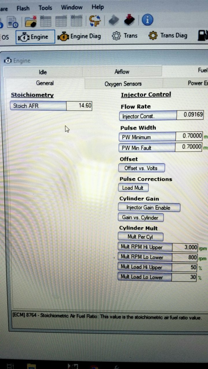

    White lightning boosted
    White lightning boosted Well-Known Member
    Dec 30, 2017
    #239848
    8,273
    Jesse
    Poulsbo
    15' DCSB OR S/C
    Lift, pedal commander, led foglights, led interior lights, led back ups, led under lighting, urd tcai, led headlights, methanol injection, 76mm tb, hood struts, dif breather mod, ratiotek trans kit, x-series gauges, true cool trans cooler, belt wrap mod, 2.8 pulley
    I'd rather recognition be rich than lean.

    #1792
    mightytacoman
    mightytacoman Mighty-known Member
    Apr 3, 2013
    #101270
    2,412
    Kel
    4.5L 1grfe
    Brian Crower stroker kit, Carrillo pistons moly/ceramic coated, BC sportsman rods, arp s2000 head bolts, Darton M.I.D sleeves, Kelford race cams, Magnusson supercharger, hp tuner tuned, 650cc flow matched fuel injectors, CSF radiator, Walbro 255 fuel pump. pulleyboys quick change pulley with 2.3", fpr mod, NST crank, water and alternator pullies, 160° mishimoto thermostat. Puma On-board air, Radflo CDC ext coilovers with 14" 700# springs, extended length rear Radflo shocks with CDC, Dakar leak pack, Brute Force Fab front bumper galvanized and powder coated, DTRL mod, yellow fogs, fog anytime mod, relocated rear differential breather, synthetic fluids, custom airbox, tundra sized intake. 76mm throttle body, secondary air filter removed, Airflow snorkel, 4x innovation sliders powder coated, URD equal length headers, DT y-pipe, Aero-Turbine 2525xl exhaust dumped over axle, seat belt chime disabled, Warn 8000i winch, 1- 20" slim light bar in grill, 42" curved roof light both with custom brackets. Mesh grill, Brute Force Fab rear bumper with extra reverse lights, u bolt flip kit, SS extended brake lines, hockey puck bump stop extension, AT shackle flip kit, Light Racing UCA's, 4crawler 1.5" bodylift. custom built front and mid skid plates, re-geared to 4.56s, windows tinted 25%, Sony stereo, 8" skar sub-woofer, 1000 watt mono amp, retrofit headlights with legal demon eye, Kryptek Marathon seat covers. North Star agm 27f battery, Helo 791 rims, 315/75/r16 Mt/r ARB front air locker
    agreed, I was surprised to see it off though. That isn't typical for toyota engineers IMO
    Dec 30, 2017
    #239848
    8,273
    Jesse
    Poulsbo
    15' DCSB OR S/C
    True.

    #1795
    loginfailed
    loginfailed Well-Known Member
    Aug 29, 2016
    #195923
    5,156
    Dwayne
    Houston, TX
    2014 DCSB 4WD
    I saw that too, but left it alone. 0.1 isn’t going to make much difference in the big picture.
  16. Apr 23, 2019 at 6:47 AM
    #1796
    12TRDTacoma
    12TRDTacoma Powered by Ford, GM, VW, and Mercedes
    Aug 20, 2012
    #85133
    16,673
    Rob
    Concordia
    12 TRD Sport DCLB 4x4 Supercharged
    Boosted
    You'd be surprised.
  17. Apr 23, 2019 at 6:48 AM
    #1797
    loginfailed
    Aug 29, 2016
    #195923
    5,156
    Dwayne
    Houston, TX
    2014 DCSB 4WD
    I doubt it.
  18. Apr 23, 2019 at 6:53 AM
    #1798
    12TRDTacoma
    Aug 20, 2012
    #85133
    16,673
    Rob
    Concordia
    Boosted
    You doubt it, but I know it.
    A car running 14.8 that is north of 150K will burn out the cats much quicker than a car which is running 14.7 all day long. This is especially amplified after 200K. Which is usually when sensors start getting lazy, plugs are not being replaced etc.. Not that it is important in your case or most of the guys outside of Californias case.
    All it takes is .1 to be off on the lean scale over an extended period of time and for the average car driver which is not mechanically inclined or privy on HPT is easily paying hundreds, if not thousands for new replacement OE converter(s).
  19. Apr 23, 2019 at 6:55 AM
    #1799
    loginfailed
    Aug 29, 2016
    #195923
    5,156
    Dwayne
    Houston, TX
    2014 DCSB 4WD
    You can change yours. Mine is staying at 14.6.

  20. Apr 23, 2019 at 6:57 AM
    #1800
    12TRDTacoma
    Aug 20, 2012
    #85133
    16,673
    Rob
    Concordia
    Boosted
    You're good if it is richer.. if they set it at 14.8 that would be a problem. 14.6 is going biased rich so it's okay.
    The point I was making is that .1 eventually does matter if it's .1 lean.
