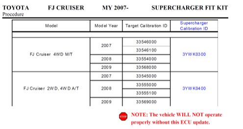

    Oh yeah almost forgot! ********SPECIFIC TO THE FJ CRUISER*****
    Got an email from @HPTuners this am! "added support for 3YWK0400 in the latest VCM Suite 4.3.575 or later"
    They added support for the TRD Calibration on 2007/2008/2009 factory flashed supercharger id's.....this was available in August 2008 as an update to the original TRD Calibration and fit kit.
    However, if you're like me and added the supercharger right when it came out in 2007 and early 2008, then you may find yourself with calibration id 3YWK0200, which they don't have support for yet. My HPtuner is in route, so I'll see what id I'm working with for the supercharger installed and flashed in March of '08
    Edit, updated the original flash date to march 08

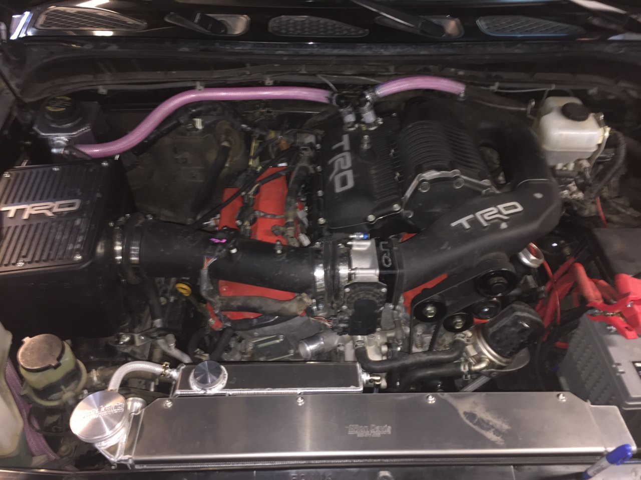

    That is a great looking engine bay. Nice work! Custom radiator and intercooler reservoir?
