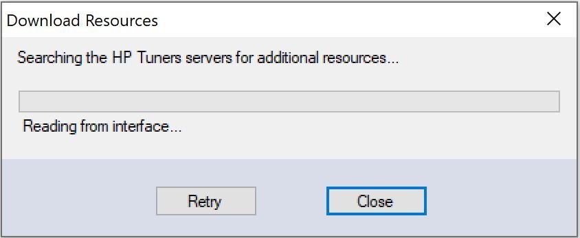

    Anyone else getting stuck on this window this afternoon when trying to open a tune? @HPTuners

    Disregard, it started working. ¯\_(ツ)_/¯

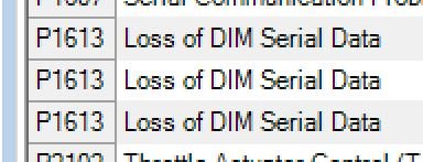

    So I was out logging, and this popped up. Anyone seen this before?

    Granny shifting, not double clutching like you supposed to

    Did your floor pan fall out of the truck at the same time?:D

    Did you blow the welds on the intake?
