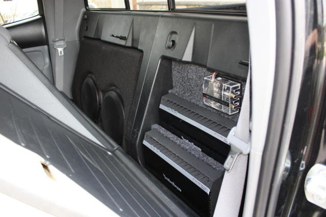

    Do you know where I can find a tutorial on how to do my setup like this??

    As rock lobster said, That is a JL Stealthbox. They're not cheap but they're nice enclosures. The amp rack is custom built. It doesn't look like there's much to it, really, but if you're unfamiliar with this type of stuff, you'll find it hard to do at first.
