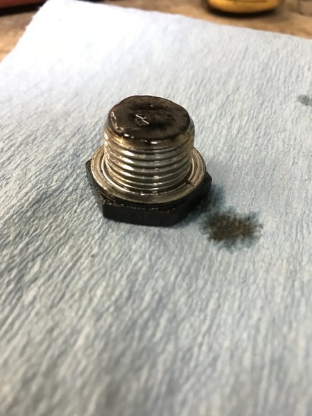

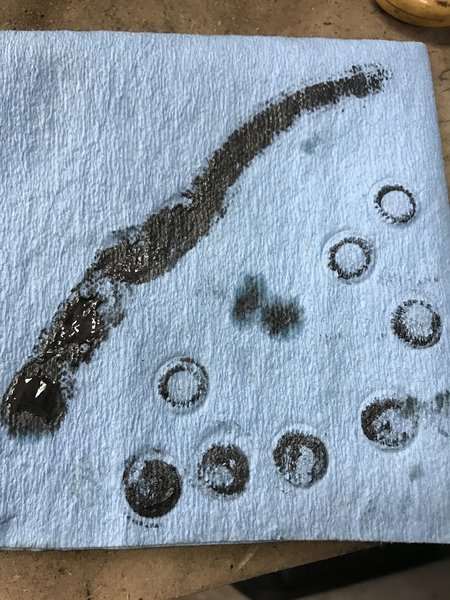

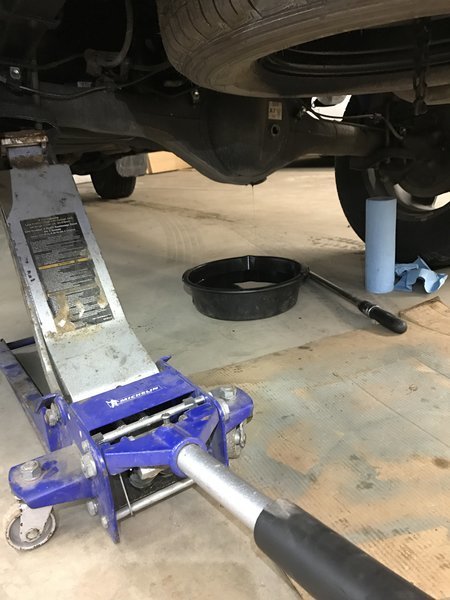

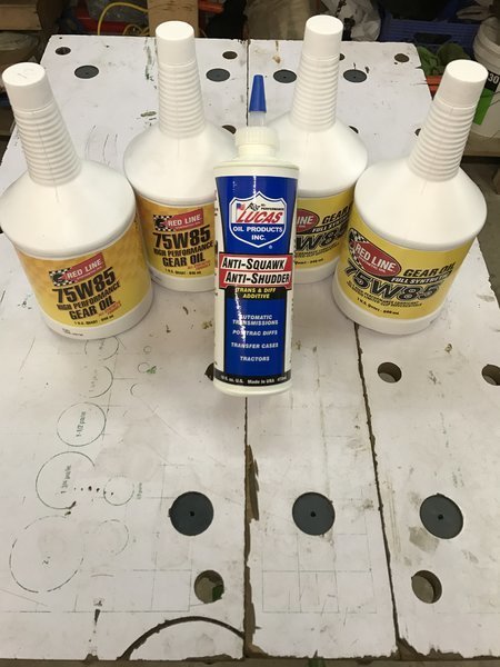

    Reporting back as promised.
    I changed my rear diff fluid today and added the Lucas product as well.
    I followed @BamaToy1997 instructions with the break in procedure afterwards.
    At this point the noise is still there when feathering the throttle.
    The drain plug had lots of crap stuck to it.
    I was surprised as to how contaminated the fluid had become in 4300 kms.
