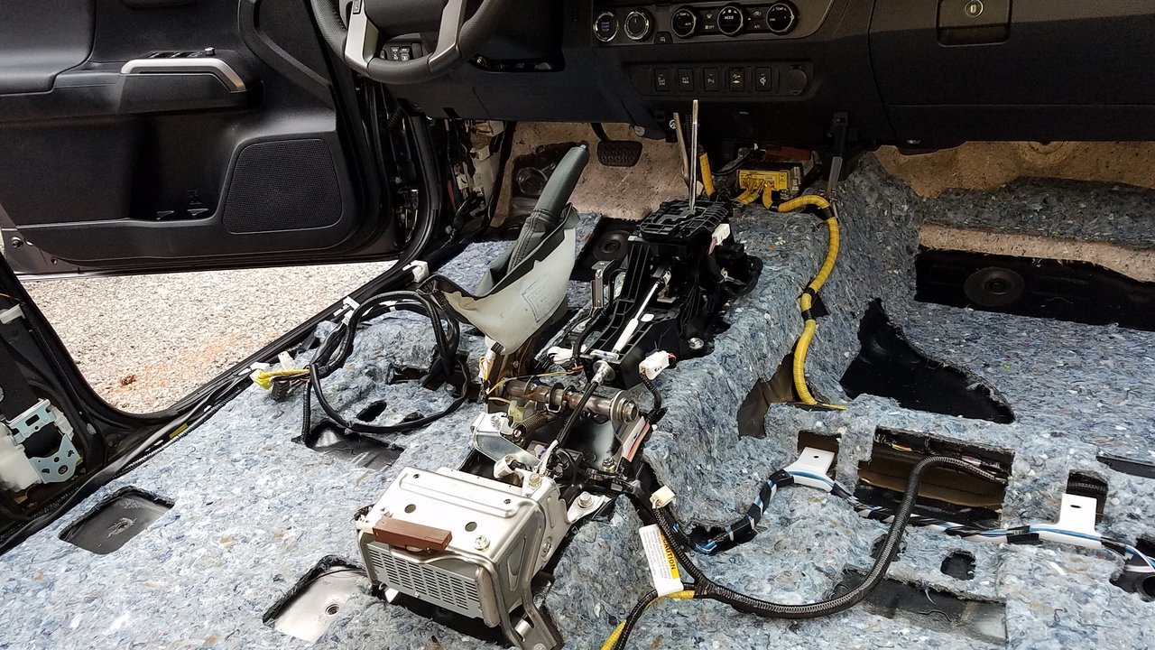

    Op has already seen this but posting it for anyone else with water damage. Lots of wiring for the seat sensors, airbags, etc. Just a pick of what's under your carpet..20170725_194011.jpg

    2017 Tacoma TRD OR Quicksand
    Ok thanks!
    I will get all that checked!
    If any wiring ...sensor diagrams come up....let me know!

    WD-40 means water displacer, 40th formula. It's really good at it too, not just a lube. Need to try and find all your electrical connections and get the water out of them.
    You could just say eff it and tear all your carpet out. Have a sweet hose washable floor, like them Jeep guys. Lol.
