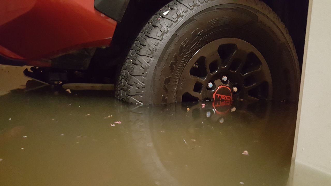

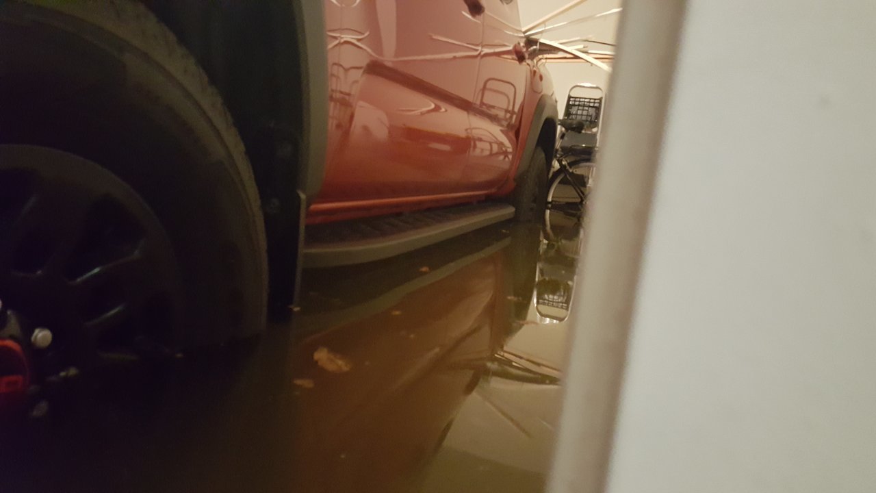

    Water didn't make it into mine, luckily, but much of the undercarriage was submerged for a significant amount of time.
    Am I better off going through insurance or just having basic maintenance / fluid changes done myself?

    Looks like you should be fine IMO.
    I would just drain & refill the diff fluid and use new plug(s) washers (2) in case some water got thru the axle seals. The front hubs are questionable as they're sealed and you can't lube them.
    They can go thru lots of deeper water just fine, I've done it plenty times but being half submerged in water all that time is the issue. At worst case you just replace them (hubs) and be done.
    If it was me, would just drive on for now and pay close attention to any grinding noises that would occur after a while if the lube got watered down. For peace of mind on a long trip, I would just replace them, easy job not too expensive on line parts and close the page
