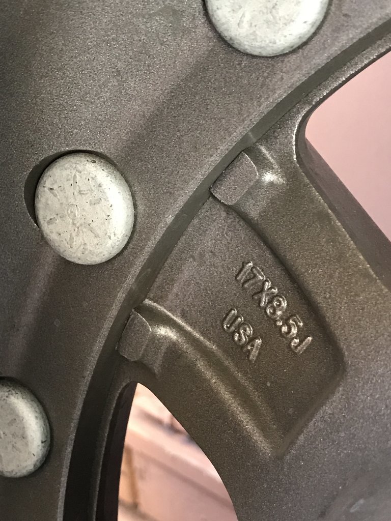

    I've had these wheels for a long time. Get a couple spare nuts and do get a spare white o ring. If you ever dismount and mount the tires again it's easy to pinch it when bolting them back together. Don't stretch the o ring to seat it. I never have and it helps hold it in place. When bolting them together, there are alignment tabs on the back of the wheel, don't rely on them to center the wheel. Instead, take a 2x4 and tap the face of the wheel in whatever direction you need it to fo. Those alignment tabs will shred a little each time you assemble the wheels (afterall its just aluminum and soft) and you won't center them. That will cause vibrations. I've also never had to balance the wheels and I've run everything from 35s to 42s on them. If you assemble the wheels so that they're centered then you should be good. Other than that, they're great wheels. They're heavy but the best beadlock.

    Awesome. You talking about these right?
    I didn't smash any :)

    Yep, those. Try to keep it that way :) I had mine apart a lot since I tried a bunch of tires out. I noticed that they'd wear down a bit over time. I have a new set of wheels now though. I sold my original ones then decided I wanted the same ones again.

    Hutchinson won't sell just that main part?

    Good question, they list all of the components with their individual part numbers so it may be possible. One faceplate was slightly damaged in transit to me and upon complaint they shipped me a new faceplate and didn't have any interest in having the damaged one returned.

    I'm sure they do. I didn't sell them because they were worn out. It was just something I noticed that would eventually become an issue. The wheels were still perfectly fine. I sold them since I changed directions with my truck. Was actually going to sell it but then dumped 60k into instead.
