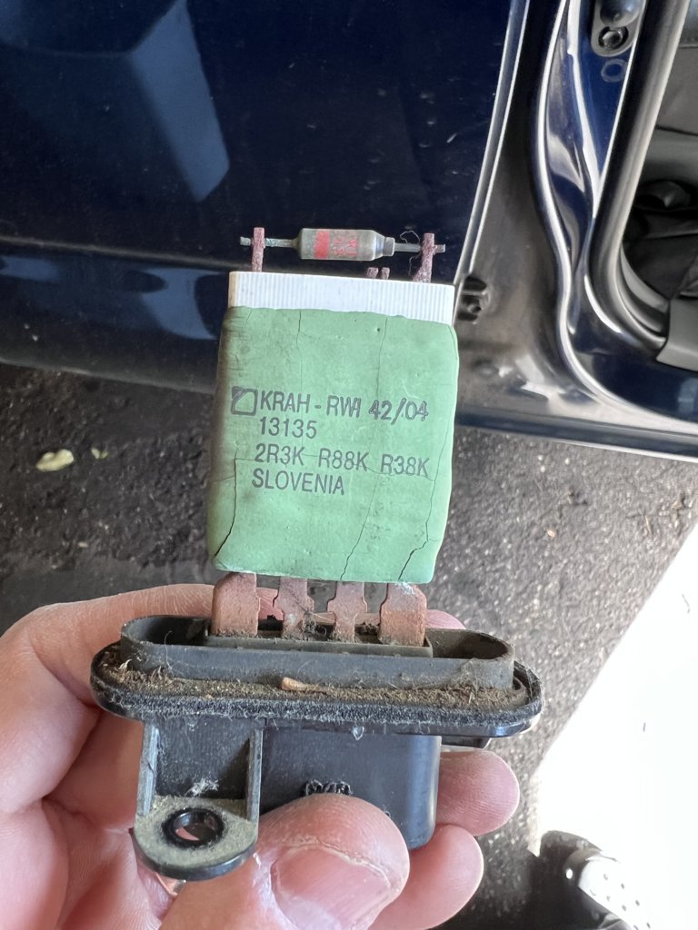

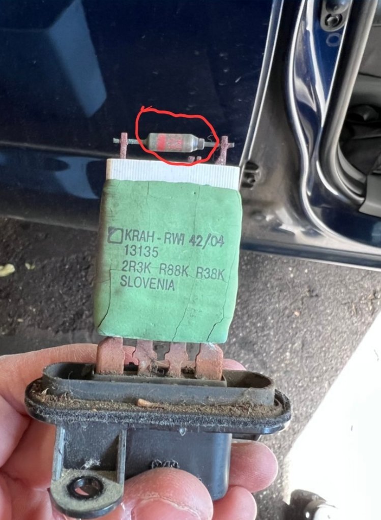

    Morimoto projector retrofit w/ Profile halo DTRL, Morimoto LED fog lights, full custom stereo
    Just as a data point, here’s what my old one looked like.

    Usually not, it's usually the thermal fuse that blows on them. Which you could check that with a multimeter.

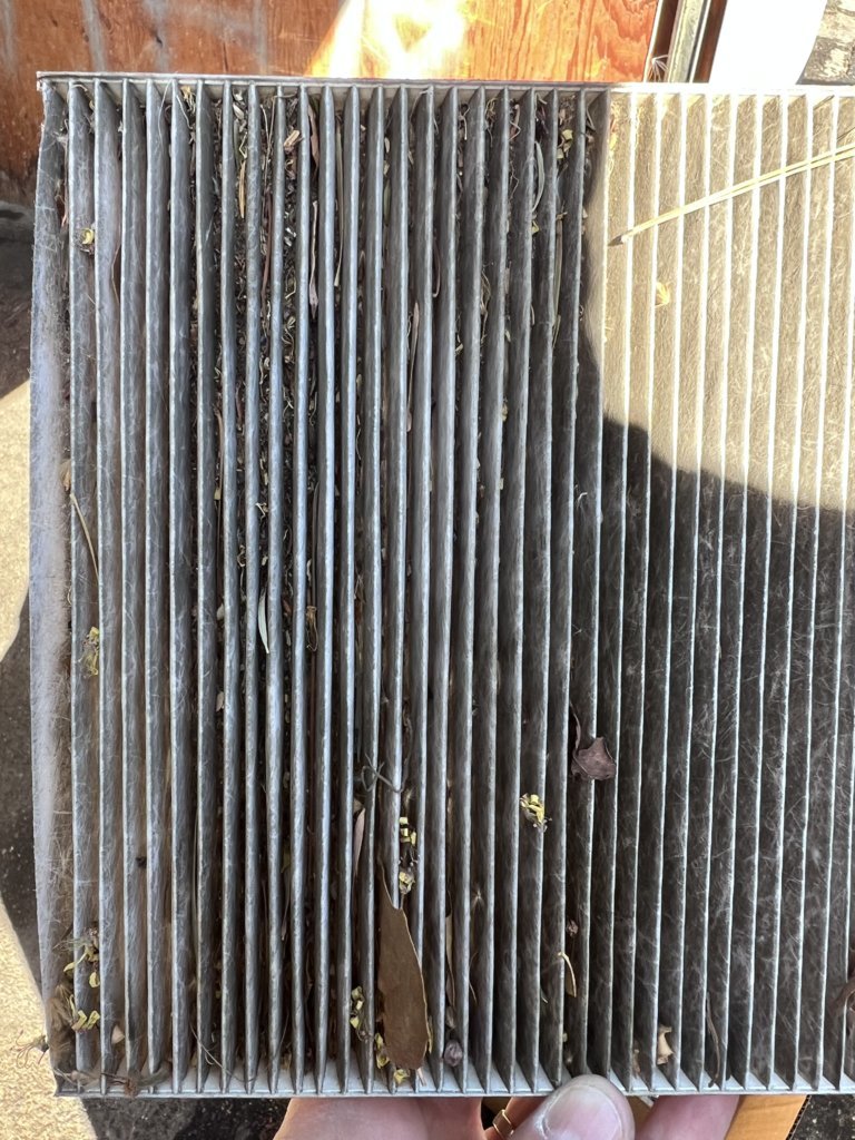

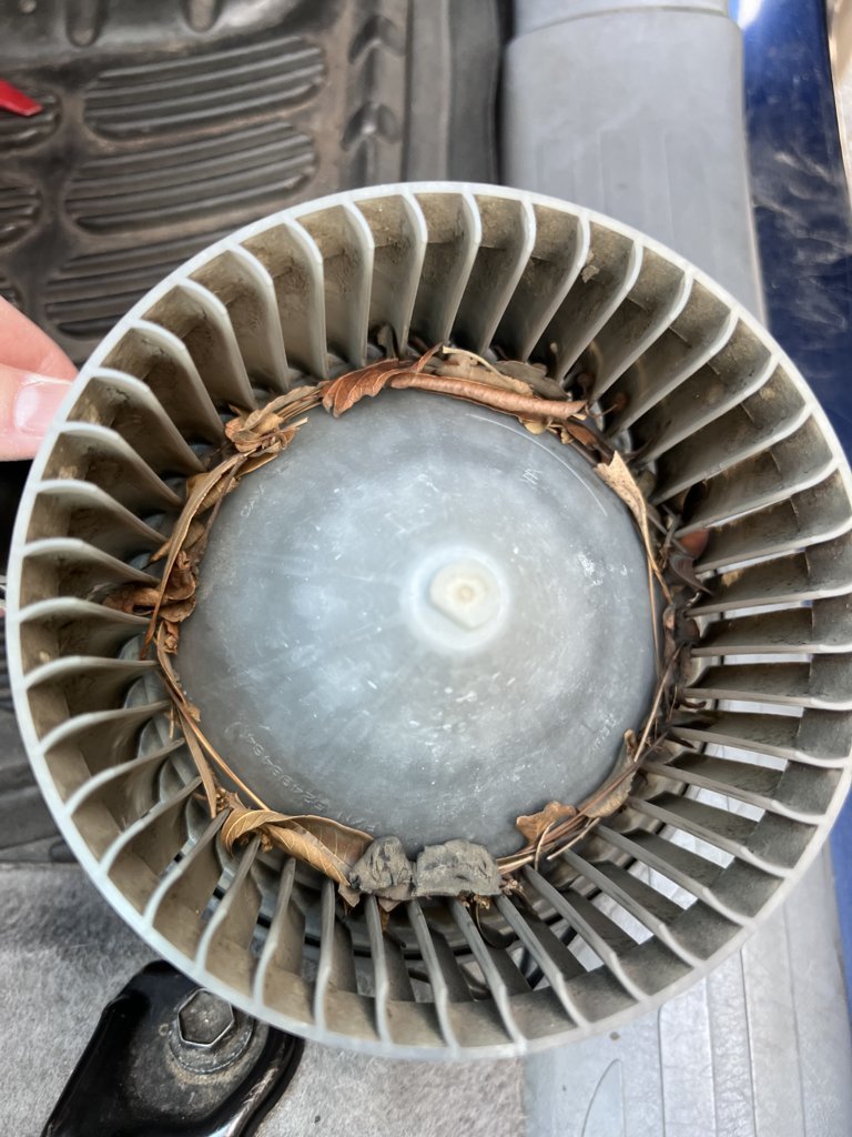

    IMG_9527.jpg IMG_9524.jpg Alright. New parts installed.
    Another new resistor
    New blower motor
    Cabin filter
    Pulling the blower motor, it was pretty dirty. There was some resistance to spinning compared to the new one but certainly not seized. And the old cabin filter was pretty packed and dirty.
    And this was obviously why it stopped working again after replacing the resistor the first time. But I think this is the designed failure mode, so I’m hoping the extra draw from the dirty filter and old motor was the cause.
    It all works again just hopefully permanently now.

    Eww yea that is pretty bad although I've seen worse.
    Looks like the thermal fuse on the resistor failed as designed either due to lack of airflow and/or overcurrent from a bad blower motor.
